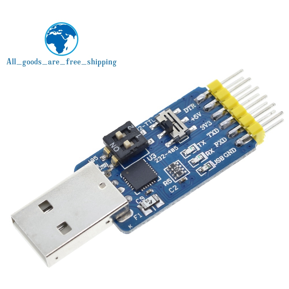

  • Hi all,
    Thanks for the prompt responses.  But....
    I do using a MSP-FET as the JATAG connector to the target, which can only be used for loading and developing the code.  It can not be used to test its peripherals like eSCI_A UART, can it?   That is why I kept asking for the USB_to_TTL adapter that you know it works to communicate the chip and the Hyper Terminal in a Window 10.
    Are you sure the one shown in the picture working?  Have you ever used it before?  Please advise.  Thanks.

  • Hi Johnson,  Thank you for the info of USB-UART adapter.  What is the difference between USB-UART and USB-TTL adapters?
    Thank you for your kindness as well for keeping asking me to look into the UART capability in MSP-FET device....
    But I still don't think using MSP-FET to communicate PC is not going to fit into our applications.  As I mentioned before we are evaluation TI chip MSP430FR5739 with development kit MSP-TS430RHA40A.  And it can be a key low-power DSP used in our product in the future.  If it is qualified, it might show the potential of ordering up to a thousand units at our first production phase.
    And now we are getting into the point to ensure whether the peripheral eUSCI_A UART would be able to talk to PC Window10 through some types of adapters.   So far we have not been of successful in the selections of these adapters.  We believe you must have gone through these type of experiences and known what type of adapter is perfectly and reliably suitable for your product.
    Please understand what we really need and give us a hand professionally !  Thanks.
  • Hi Ted,
    UART is a serial communication protocol, TTL and RS232 are communication electrical levels.
    USB is another communication protocol.
    There are generally two interfaces on the PC: USB interface, serial communication (RS232 electrical levels).
    The eUSCI integrated on the MSP430FR5739 MCU can be configured as a serial communication protocol (TTL electrical levels). Therefore, in order to ensure communicate normal between MCU and PC. You have two options:
    1: Use the USB interface of the PC, then you need a USB-UART (TTL electrical level) hardware, this hardware has been integrated in the MSP-FET, of course, you can also buy one separately, such as the link given by Bruce: https://www.sparkfun.com/products/12731
    2: Use PC's serial communication interface (RS232 electrical levels), then you need a TTL-RS232 interface, the following link https://www.sparkfun.com/products/11189
    Best Regards
    Johnson
