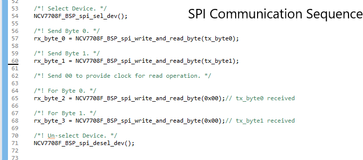

I am communicating with NCV7708F chip using MSP432P401R uC via SPI. I need to verify my each write operation by reading every write. NCV7708F has standard 16 bit spi communication implementation. The problem is NCV7708F read and write operations are simultaneous.
When I send 00 or FF to provide clock for read operation. Previously written bytes are received but it also over writes 00 or FF to chip.
My Code for read and write:
    /*! Select Device. */
    NCV7708F_BSP_spi_sel_dev();
    /*! Send Byte 0. */
    rx_byte_0 = NCV7708F_BSP_spi_write_and_read_byte(tx_byte0);
    /*! Send Byte 1. */
    rx_byte_1 = NCV7708F_BSP_spi_write_and_read_byte(tx_byte1);
    /*! Send 00 to provide clock for read operation. */
    /*! For Byte 0. */
    rx_byte_2 = NCV7708F_BSP_spi_write_and_read_byte(0x00); // tx_byte0 received
    /*! For Byte 1. */
    rx_byte_3 = NCV7708F_BSP_spi_write_and_read_byte(0x00); // tx_byte1 received
    /*! Un-select Device. */
    NCV7708F_BSP_spi_desel_dev();
static inline uint8_t NCV7708F_BSP_spi_write_and_read_byte(const uint8_t byte) {
    /*! Transmit characters. */
    EUSCI_B0->TXBUF = byte;
    /*! Wait till a character is received (this wait is necessary). */
    while (!(EUSCI_B0->IFG & EUSCI_B_IFG_RXIFG)) ;
    /*! Return received character. */
    return EUSCI_B0->RXBUF;
 Can someone please guide me how can i perform read operation without over writing data. Thank you.

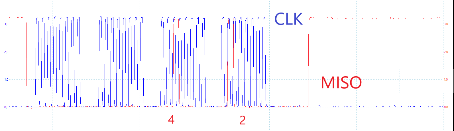

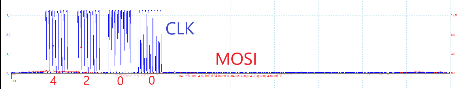

    I tried creating invalid frames for read operation but so far unsuccessful.
    Approach 1:
    After write operation I made CSB high while sending dummy bytes for read. I received FF because SO was in tristate.
    Approach 2:
    I tried all 4 combinations of clock polarity and phase (CKPL, CKPH) to find an invalid frame. But SPI communication with chip NCV7708F is same and correct with all 4 combinations.

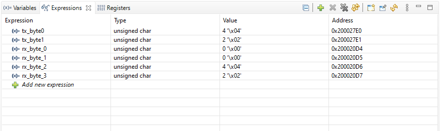

    Yeah my images attachment was unsuccessful I have attached them again:
  • It looks like you're reading back what you wrote. That tells us that (a) the SPI settings are probably correct (b) it updates the control register immediately. There's also a suggestion that the control register is 0000 at reset -- not too surprising, but I didn't find that in the data sheet.
    If you read two bytes then (immediately) write those two bytes (rxbyte_0/1) back (maybe with SRR=1?), I expect it will restore the original settings. Since doing that has potential for glitches, I suggest you only do this at startup, and (as suggested above) save away rx_byte_0/1 as a mirror of what's in the device.
