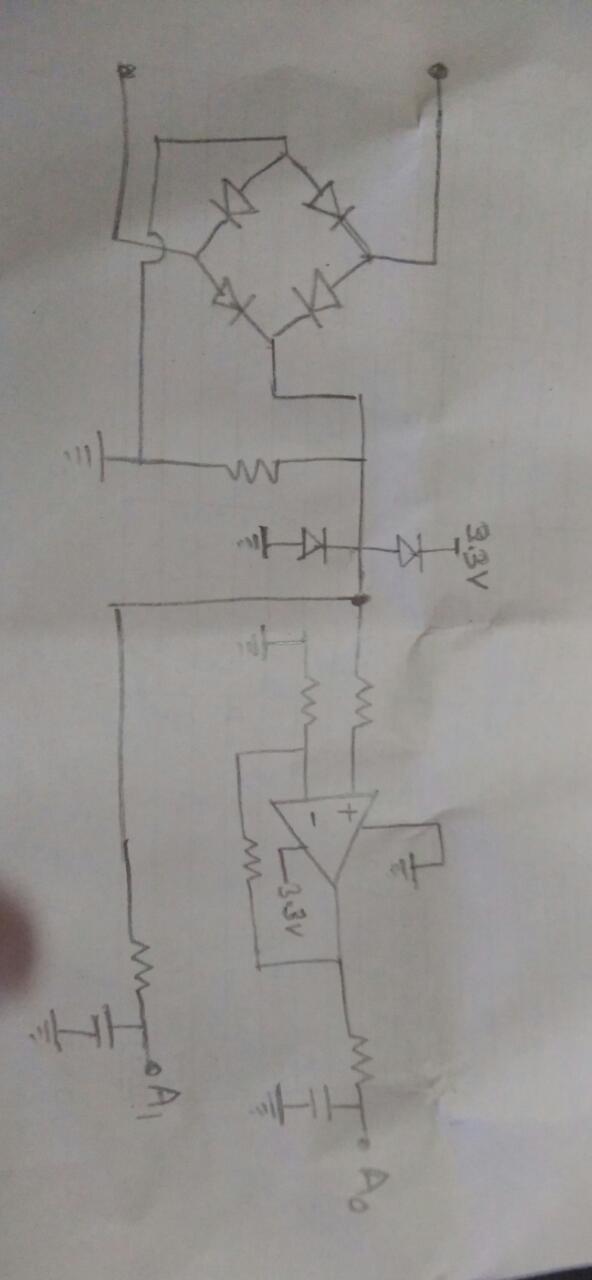

In my design , I am using MSP430 adc channels A0 , A1 , A2 , A3 & A13. A0 to A3 for ac current measurement and A13 measures a DC signal ( Max 2.5 V dc ).
Following are few brief setting information for adc application code :
  1. ADC12_A conversion sequence mode is Sequence-of-channels.
  2. Software-controlled sample-and-conversion start.
  3. Reference is internal 2.5V
  4. ADC12_A sample-and-hold time = 4 ADC12CLK cycles
Voltage to A13 channel is 2.5 in default case.
What we find that A0 channel (ADC12MEM0) reads adc count value significant enough to disturb our application even though no current is injected. Just to troubleshoot, if we reduce the signal to A13 to zero ( forcefully connecting A13 pin P7.1 to GND signal ) , the adc count reading from A0 channel disappears or reads 1 / 2 count. But we can not make channel A13 to zero as this signal is dependent on a sensor ( 0 to 2.5 V dc ).
  1. Can you please provide a FIRMWARE solution for the above  case. i.e how to minimize the effect on channel A0 from A13.
  2.  My application uses A0 , A1 , A2 , A3 and A13. Does it means that the sample and conversion time counts for those selected channels only or time will be calculated considering A0 to A13 i.e total 14 channels.

  • It seems odd that only channel A0 is affected. Is there something unique about that signal source?

  • Thanks David for your suggestions.
    not really . A0 , A2 are high gain channel from similar sensor ckt  and A1,A3 low  gain. Please see the  current sensor bridge ckt to A0 / A1 adc channel in the pic. might help in understanding my issue.

    You are correct .CONSEQ=1 (and MSC=1).There is no delay between reading the last channel and the first ,in my code. All channels are read(ADC12MEMx) once in a timer interrupt and then triggered for next sample/conversion.
    I have attached a pic of my ckt concept....in last post.

  • With an RC filter on the inputs you need to be careful about values but you show none. With R large enough to cause sampling time problems then C needs to be large enough relative to the sampling capacitance so that after sampling redistributes charge, the change is less than 1/2lsb.
    R = 1K ohm , C = 100 nF
    OK

  • That the symptom moved with A0 really seems to suggest that it's something electrical, with just that port. The fact that it improved (even if it didn't go away) with a longer S/H time suggests something about input impedance.
    I didn't realize you were planning on adding 4 more channels. If we suppose A0 is the only problematic channel, here's another trick: Use MCTL7-15, starting with A0 in MCTL7, and set CSTARTADD=7. Set SHT0=(long) and SHT1=(shorter). This will use the longer S/H time only for A0.
