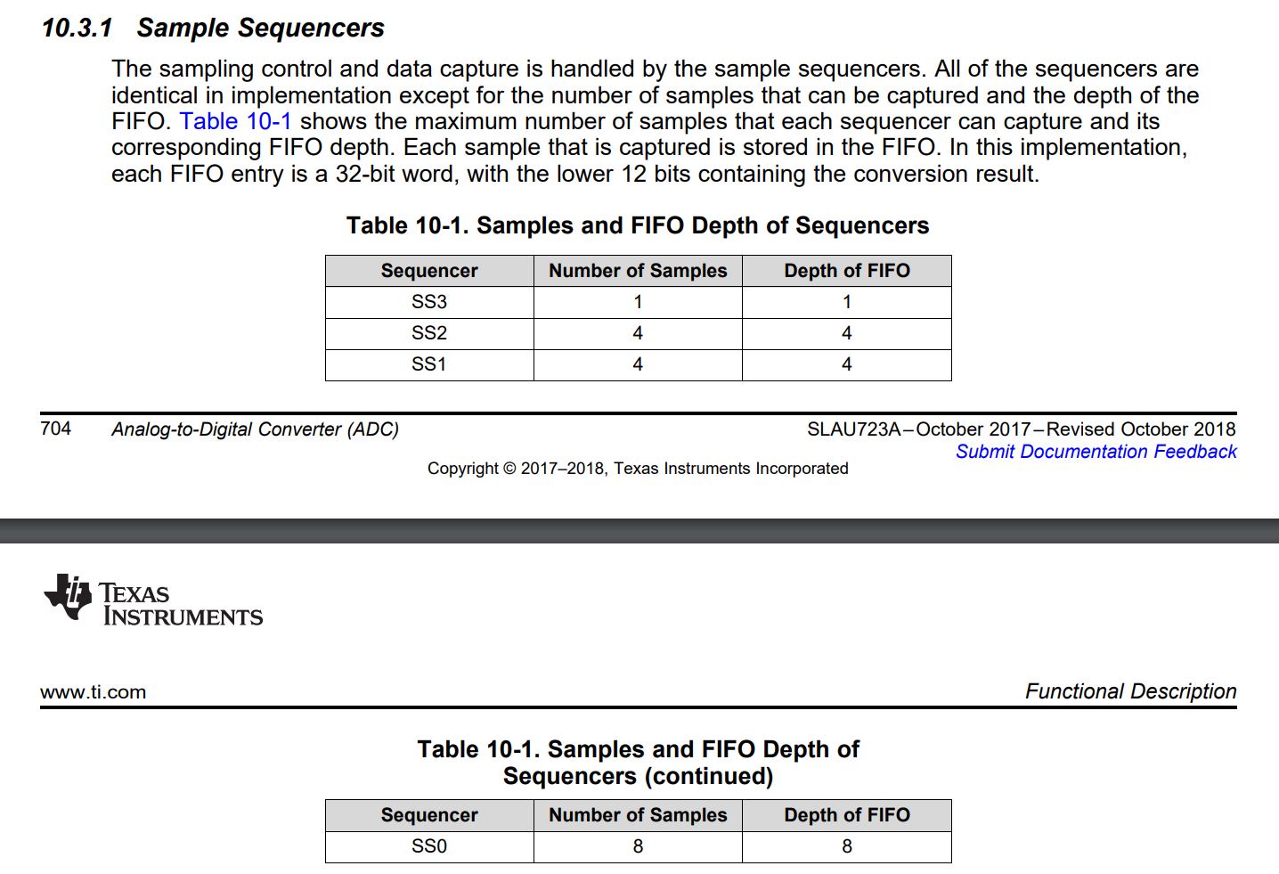

    For the details about the sequencer, please see the technical reference manual.
  • This table is not clearly answering my question about Sequencer’s Depth.
    In CCS  *.SysCfg TI is using the word “channels” meaning inputs with pin number. That is, I can
    connect to SS0 let’s say 8 sensors. In TI reference manual the word is “samples”. The “depth” is equal
    to the number of “samples”.
    Rephrased question 1: Does this mean that SS0 has only 8 electronic registers to hold the data, or it has
    8 x 8 electronic registers? That is if I have 8 inputs (8 samples) – each input has the depth of 8, that is
    total number of data that the SS0 is holding is 64 ?
    Rephrased Question 2: If I have 4 inputs connected to SS0, does this mean that the depth is 2 (shared),
    or the depth will be 8 for each input?
    Question 3:  Also, I asked to check the example with the last SDK 4.20.00.12. This is not my
    programming. This is TI SimpleLink Academy Lab named “ADC Simultaneous Sampling”, with some
    modification according to Lab instructions and using only one channel and SS0 for each ADCs.
    This is not the same SS0. Each ADC0 and ADC1 has its own SS0. This is not the only TI Lab Example
    that is not working.
    Thank you in advance.
  • Sequencer 0 has 8 FIFO entries (words) total. [Ref User Guide (SLAU723A) Sec 10.3.1 (final paragraph) and Table 10-25]. It has 8 entries total even if you're only sequencing one channel, so in theory you could run 8 such sequences before you have to unload the FIFO.
    The FIFO depth doesn't need to be the same as the sequence (channel) count, but that's what they chose. It really ought to be at least the sequencer count, or with a "full" sequencer any hiccup in the DMA would cause an overflow, and non-DMA would be infeasible.
    I'm not familiar with SimpleLink Academy, so someone else will have to help with that. If you changed something, though, that would be a place to start.
