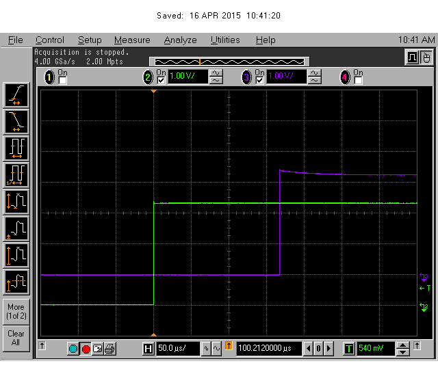

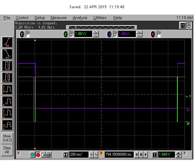

  • Hi Shinichi,

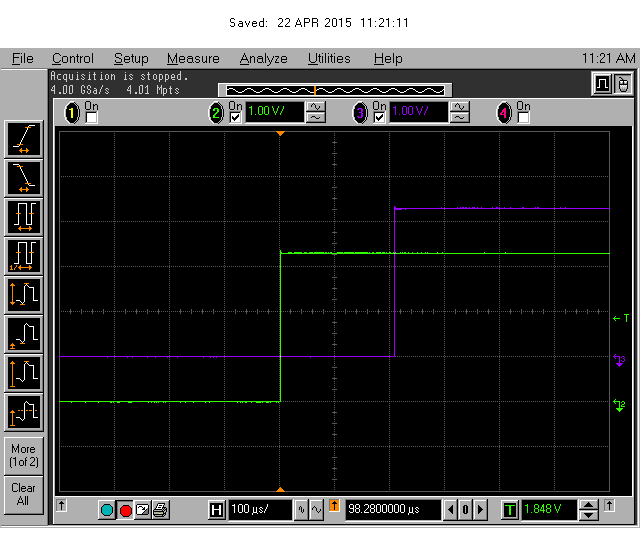

    First of all, make sure that you program R0 after CE is resumed to HIGH. This is required to re-calibrate the device after powerdown. The following illustrates the timing sequence after powerdown is resumed.
    CE goes HIGH -- wait time --> Program R0 -- response time --> MUXout becomes HIGH
    Total MUXout delay time after CE is HIGH = wait time + programming time + response time
    Wait time = 100us typical
    Programming time = depends on your system. For example, if the CLK rate is 1MHz, programming time = 24us.
    Response time = 76us typical

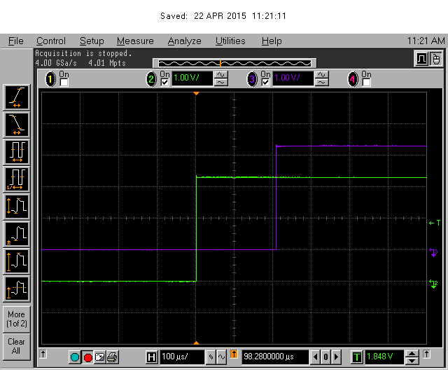

    here is the waveform. Green = CE, Blue = LE, Pink = MUXout
    Picture 1. CE goes HIGH, then program R0. After LE goes HIGH, MUXout becomes HIGH.
    Picture 2. this is the zoom of LE and MUXout traces.

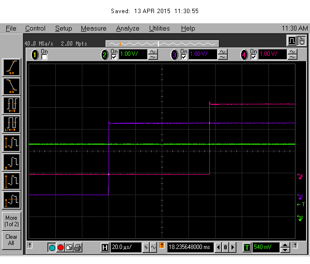

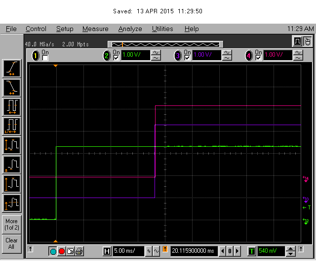

  • Hi Manabu,
    Here is my test result with the following configuration:
    OSCin = 25.2MHz
    MULT = 2
    fpd = 50.4MHz
    VCO = 4800MHz
    Fout = 480MHz
    Program sequence:
    1. Power down - program R0 with FCAL_EN=0, POWERDOWN=1
    2. Power up - program R0 with FCAL_EN=0, POEWRDOWN=0
    3. Reload R0 - program R0 with FCAL_EN=1, POWERDOWN=0
    Green trace = LE in step 3. Blue trace = MUXout.

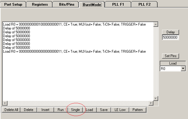

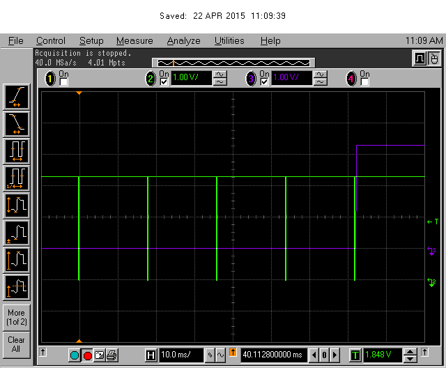

  • Hi Manabu,
    It seems that the customer is not using the latest codeloader, pls use the latest codeloader which is available to download from our website.
    Anyway, I think the problem is from the codeloader, there is some bugs here.
    in the following plots, green trace = LE, blue trace = MUXout.
    This plot shown, in the "Bits/Pins" tab, if you click POWERDOWN bit once (from 1 to 0), instead of programing the device once, codeloader actually program the device a couple of times. as we can see below, there are several LE pulses. From the last programming, you can see MUXout resume to HIGH. So if you measure the time when you click the button until MUXout is HIGH, you will get more than 70ms.
    We can use BurstMode to get away from the bug.
    in the "BurstMode" tab, we can create some specific sequences to program the device. For example,
    The first R0 is with POWERDOWN bit =1. Then I added a lot of delay between the second R0. The second R0 is with POWERDOWN=0. In the bottom, click the highlighted button until you get Single. After that, click the Run button, codeloader will program the device with the first R0, then Delay and then program the device with the second R0. That is, first powerdown and then resume powerdown.
    Here is the plot after you click the Run button. There are only two LE pulses, which is expected and correct. The time interval between powerdown and powerup is more than 1 second.
    once it is powerup, MUXout goes up in about 200us.
    here is the configuration file with BurstMode script. Make sure you use the latest codeloader to restore this file.
    e2eB.zip
