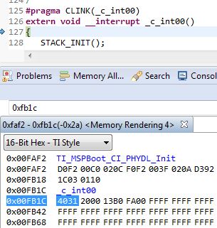

Hello Luis,
Now I am trying to build and debug App1_MSPBoot (MSPBoot is already flashed to controller). I changed the cmd file for MSP430FR5969 accordingly (file attached for your reference). But when I start debugging.... application starts running immediately with Resume(F8) button disabled.... and when I suspend execution (Alt+F8) it says No source available for "0x4". Additionally the application is not doing what it is supposed to do (toggling P4.7 pin).

  • Hi Deep,
    I created a new thread for this question. It's difficult for us to track updates to threads that have been already answered.
    Is CCS mass-erasing the device when you download the application? Try loading the bootloader first, then load the application using a different Debugger Download Option (i.e. "Replace Written Memory locations, retain Unwritten memory locations").
    It's also important to remark that by default, CCS projects try to run and only stop when they hit main(). If your application doesn't go to main() (because it's in bootloader), then it won't stop automatically. You can disable the option to run to main(), so that the debugger stops at the first instruction after reset. Note that in your case, you seem to have erased the bootloader since the device is executing at an invalid memory.
    In order to debug this kind of issues, I recommend you to try to take a few steps back and try to trace the root cause of the problem.
    1) Check the reset vector, is it valid and pointing to the right location (in this case it should point to the start of the bootloader)
    2) Try resetting the device in the debugger (with "Run to Main" disabled) and you should start executing at this first instruction of the bootloader. Optionally, set the PC manually to this address
    3) The bootloader (if executing correctly) will decide to stay in bootloader mode or jump to application. If it stays in bootloader, can you see if the device gets stuck in a loop waiting for the packets? Or if it tries to jump to application, is it jumping to the right address?
    Luis R
  • Hi Luis,
    Thanks for your response. Answers to your points:
    1. I checked the reset vector it points to _c_int00
    2. yes it starts executing at _c_int00
    3. it is stuck in the loop waiting for the packets.
    Additionally I tried to create the C array (size 7KB) of the APP1 and tried to flash it using TI_MSPBoot_MI_WriteByteDirect() in the main(). With this I could not build the project and was getting error #10099-D: program will not fit into available, I suppose it was because of its size (7KB). Can you please suggest if there is some other way to do it? Attaching array.c file.
    Deep

  • Have you tried single-stepping in assembly to check where it fails? If you have, when does it fail?
    Are you configuring the flash timing before calling the function? The FCTL2 register is configured in the EraseSector function
    Luis R
  • Hi Luis,
    It worked, thanks for your support!! It was stuck at CRC checking.
    As mentioned in the last post that I had created the C array (size 7KB) of the APP1 and was getting error #10099-D: program will not fit into available. To overcome this issue I have just used 2 small arrays App1Array_0[181] and App1Array_1[51] and could finally run the code (main file is attached for your reference).
    1. One issue here is when I run the project thru debugger it runs with no problem. But with power-on the it behaves differently, the application is reset as soon as it jumps to the application (main file and command file is attached for your reference).
    2. Additionally I want to know, how I can use the existing BSL to upgrade the firmware via simple UART cable through PC. Is there any such tool available?

    Further I moved one step ahead and tried to use a timer interrupt in the application (main file attached). The issue I am facing is.... when I configure the timer interrupt and enable the interrupts using '_enable_interrupts();' my application is resetting continuously. Timer ISR is never hit but the application is reset. The cmd files for both MSPBoot and Application are the default cmd files '5KB_Dual_Boot'. Could you please let me know what is going wrong?
    When I tried to debug the assembly it says no code available for 0xfb1c (Print screen attached) and this 0xfb1c is actually '_c_int00' of the bootlader (MSPBoot) (Print screen attached).
    I have also attached the application.
    Deep

  • Hi Deep,
    - Start by checking the hardware interrupt vectors which should be in the appropriate location. I.e. according to the datasheet (www.ti.com/.../msp430fr5969.pdf), the TA0 vectors are in 0xFFE8 and 0xFFEA.
    Regardless of where you put your application, the vectors will always be in this location. As mentioned previously, the Flash implementation of MSPBoot redirects the vectors using a Proxy table, but the FRAM implementation simply overwrites them (except for the reset vector).
    If your application was written correctly by the bootloader, the vectors should be overwritten with the address of the interrupt routine of the application. If you see incorrect values, then the booloader is not writing the vectors properly.
    Luis R
  •  Yes I have enabled ISR for TA0 vector 0xFFEA. By writing below lines:
          TA0CCTL0 = CCIE;                          // TACCR0 interrupt enabled
          TA0CCR0 = 50000;
          TA0CTL = TASSEL__SMCLK | MC__UP;          // SMCLK, UP mode
     and for ISR I have used TIMER0_A0_VECTOR (#pragma vector = TIMER0_A0_VECTOR).
     I flashed the MSPBoot first using debugger and then flashed Main app again using debugger, so my Main application (App1) is not written by bootloader but by the debugger. Now when I debug my application and enter the _enable_interrupts() it says no code available for 0xfb1c which is '_c_int00' of the bootloader (MSPBoot).
     I understand that I need not to do any thing extra for vector redirection, is my understanding correct? Because after flasing the Main app the MSPBoot checks the CRC of the Main app and if it correct then it directly jumps to the application and does nothing specific to overwrite the interrupt vectors.
     In FRAM, MSPBoot overwrites the interrupt vectors but when updating the Download app to Main app not in the above use case.
     But while debugging the Main app I checked checked 0xFFEA in the memory browser and found the it 0xFF (attached the snapshot). Not able to figure out the problem.
     Hope I could explain my problem to you.
     Deep
  • Hi Deep,
    I think you answered your own question.
    MSPBoot will "remap" the application interrupt vectors when it's receiving the new image, but the debugger doesn't do that automatically.
    This happens on the following function:
    uint8_t TI_MSPBoot_MI_WriteByteDirect(uint16_t addr, uint8_t data)
        *(uint8_t *) addr = data;
        if ((addr >= APP_VECTOR_TABLE) && (addr < APP_RESET_VECTOR_ADDR))
            // If address is an interrupt vector, copy directly to interrupt table
            addr = (addr - APP_VECTOR_TABLE) + BOOT_VECTOR_TABLE;
            MPUCTL0 = MPUPW | MPUENA;   // Enable access to MPU registers
            MPUSAM |= MPUSEG3WE;        // Enable Write access
            *(uint8_t *) addr = data;   // Write the vector
            MPUSAM &= ~MPUSEG3WE;       // Disable Write access
            MPUCTL0_H = 0x00;           // Disable access to MPU registers
        return RET_OK;
    In your case, I assume that the debugger is placing the vectors in APP_VECTOR_TABLE and not in BOOT_VECTOR_TABLE.
    I didn't really anticipate this case, but perhaps something that can be done after reset is to make sure that both tables match.
    • A simple way to do it is just to copy everything from (APP_VECTOR_TABLE>= addr < APP_RESET_VECTOR_ADDR) to BOOT_VECTOR_TABLE;
    • optionally, you could compare them first, and only copy if necessary
    • or a third option that I can think of is to use an FRAM flag which is set only when the vectors are written by TI_MSPBoot_MI_WriteByteDirect
    I think something like this should work to copy the table:
    void TI_MSPBoot_CopyVectorTable(void)
    	uint16_t v_addr;
    	uint16_t p_addr;
        for (v_addr = APP_VECTOR_TABLE; v_addr < APP_RESET_VECTOR_ADDR; v_addr+=2)
        	p_addr = (v_addr - APP_VECTOR_TABLE) + BOOT_VECTOR_TABLE;
        	 *(uint16_t *) p_addr = *(uint16_t *) v_addr;   // Copy vector
    As you probably already saw, the application is validated and jumped to in the following instructions, so you would have to implement the "workaround" before jumping to the application;
    // Validate the application and jump if needed
        if (TI_MSPBoot_AppMgr_ValidateApp() == TRUE_t)
            TI_MSPBoot_APPMGR_JUMPTOAPP();
    Luis R
