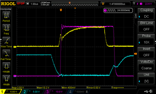

  1. During the rising edge of the high side FET we can observe the Vgs holding at 4.5v just as the SH node starts coming up. After this plateau we expect the gate voltage to keep rising with a similar dv/dt. Similarly during the rising edge of the low side FET we observe this as the SH node is coming down. It seems that after the plateau the gate driver is no longer sourcing current as is set in the IDRIVEP but instead is sourcing at the lowest rate which it does in the IHOLD state.
  2. The second issue has to do with the IDRIVE setting of the low side driver. The IDRIVE setting for the HS drivers is 300mA for P and 600mA for N. The IDRIVE setting for the LS drivers is 100mA for P and 200mA for N, increasing the IDRIVEN_LS to 300mA results in a VGLS/VCP error and a shorted out GLA pin. We then have to replace the driver due to the permanent damage.
So essentially with low IDRIVE setting we are able to run the board very stable, but in the future we would like to get the mosfets to switch faster to increase performance. We are not sure if the two issues might be related to each other. But the image above shows a clear view of the first issue. (yellow being the high side Vgs, blue low side Vgs, purple Vds low side)

    It looks like the VGS waveform of the high side is charging a capacitive region slowly after the miller plateau is reached, which I agree, it should not turn on like this with respect to source since the dV/dt is much slower than before the miller plateau region.

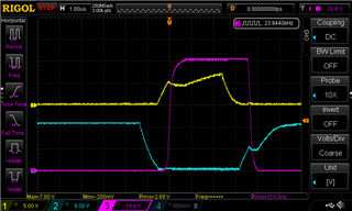

    • Increasing IDRIVE does not help with the described effect. The first slope is quicker as you may expect and some ringing starts which is not surprising. Please see the image below for a comparison of two IDRIVE settings for high side. (300mA compared to 100mA)
    • Gate traces are quite long indeed, longest trace is 85mm (Side A), shortest trace is 54mm (Side B). Please note that we do not see differences between the behavior for A or B. If trace lengths (inductance) would be the issue, wouldn't we also see the effect on the low side?
