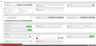

  • Hi Aaron,
    Thank you for the quick response, I had tried DNP of R66, (since R67 and R69 are already DNP'd) and I still got the MCU fault error. So I reverted back to a 0ohm on R66.
    So Following your instructions I have DNP'd R66 again, the MCU still shows a fault on the D5.
    I can get into the settings in the GUI and set to 1x PWM mode with Gain in 20V/V (Hi/Z)
    I cannot calibrate the Hall sensors and get a fail immediately, I am assuming this is because the MCU has some kind of fault. I don't know what that would be.
    Does this have anything to do with using the 5VO for the hall sensors?
  • Hi Michael,
    Thanks for sharing the GUI screenshot. I think its due to incorrect hall sensor order. This thread confirms the same issue (scroll to bottom). https://e2e.ti.com/support/motor-drivers-group/motor-drivers/f/motor-drivers-forum/963560/ccs-drv8350s-evm-configuring-drv8350s-evm-for-sensored-mode
    Can you confirm if the Hall sensor order is correct?
    Aaron

  • Hi Michael,
    To update this thread, I hooked up a DRV8350H-EVM with a sensored motor, populated the 1x PWM resistors at the Hall connector, and set into 1x PWM mode at the MODE pin. I had a lot of similar issues with Hall calibration faults, even after playing with many settings. I only got the motor to very slightly "budge", but it didn't make sense because it moved when I changed the direction.
    I agree this is painful, so my proposition is I would like to look through the code at some point, remove the Hall calibration code, reflash, and see if this improves the user experience and spins the motor.
