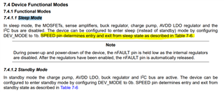

    Change address to "0x02", DDP can not write data to EEPROM of MCF8316A via I2C(always show non-ack in 9th clk, please see the attached picture).
    How to confirm if MCF8316A is in sleep mode? If in sleep mode, how to wake up from sleep mode?

  • Hi Jason,
    We can aim to provide a follow-up response early next week from Eric.
    In the meantime, wanted to drop in one quick comment regarding the SLEEP mode configuration
    • it's configured by the SPEED pin (see description, and table sections)
    Andrew
