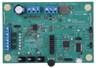

Hi team,
Here a question from my customer:
Based on our initial testing the MCT8316 peak output winding current limit (IOUT) of 8A set by ILIM is a limitation for our application, can we increase voltage at ILIM to VDD/2 i.e 1.65V  by changing R10  on EVM to 10K to increase winding current considering max duty cycle of motor operation at 80% in our application.
Can share winding current waveform if required.
KR,
Frank
  • Hi Frank,
    You can adjust the ILIM analog value for cycle-by-cycle limit overcurrent protection by adjusting resistors R10/R11 as shown below.
    Currently on the EVM these values are defaulted to set the ILIM voltage to 1.25V, which is about an 8-A overcurrent limit.
    You can use this calculator to assist with ILIM resistor divider calculations: ILIM_Calculator.xlsx
    Aaron
  • Customer feedback:
    Thank you for clarifying, then there is no scope to increase winding current limit considering (VDD/2) –  0.4 as the minimum permissible for V_ILIM as per datasheet.
    Only if we get confirmation from your technical team, we will exceed winding current beyond 8A by setting V_ILiM to 1.05V for 12A Current Limit.
    This is wishful thinking, right?
  • Hi Frank,
    Cycle-by-cycle (CBC) current limit protection is intended for overcurrent protection over continuous operation, because the MCT8316Z absolute maximum current rating is 8-A peak. So the analog ILIM voltage that can be used to set the proportional overcurrent CBC limit is 1.65V to 1.25V for 0 to 8A, respectively.
    For a transient overcurrent event, such as a shoot through current in the integrated FETs, the IOCP threshold is fixed at 16-A in the hardware device, or configurable to 16-A or 24-A in the SPI device.
    Unfortunately there is no way to implement a configurable 12-A current limit in the MCT8316Z device.
    Aaron
