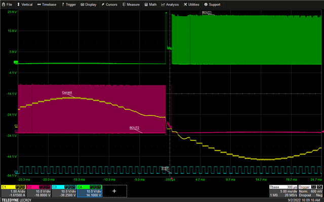

  • Raj,
    It is a US holiday today.  Please expect a response tomorrow.
    Ryan
  • Hey Raj,
    Sorry to hear that you were declined free samples, I'll see if I can help with that.
    Can you provide me with an oscilloscope waveform similar to the image below, and a zoomed in version of the same on any problem-areas?  Showing the phase current, AOUT1, AOUT2, and nFAULT signal.
    Also can you post or directly send me the full circuit schematic (at least for the power input/regulation and motor drive sections), and maybe your PCB layout as well if you don't mind?
    Jacob
  • Hello Jacob,
    Good day and hope you are fine.
    As you demanded, I have captured some oscilloscope waveforms for you but I have only 2 channels so have arranged them accordingly.
    Rsense right now is 0.135ohm and I've set voltage divider of 60.4k & 10k and thus Vref is 0.468V and I checked in DSO, it measures 0.454V so same. and according to the calculation, the current limit is 0.694A. And I'm giving 12V by attaching two wires below 470uF through the DC power supply.
    Another 3.3V is for the STM microcontroller.
    A+ voltage and A+ current: (current was AC coupled and Voltage was DC coupled in DSO settings)
    zoomed:
    zoomed more:
    My colleague said the noise seen in the current can be because of the current sensor we are using and can be ignored.
    A+ voltage & A- voltage:
    zoomed:
    zoomed more:
    zoomed more:
    A+ voltage with nFault signal:
    My colleague also said that we are already using nFault signal to stop the code whenever it shifts from high to low and it never did. So, there is no nFault fault in the randomness.
    Also, I saw signals similarly for B+ & B- winding and those were the same ones and so didn't attach them here.
    The Schematic is the same one I've shown you before and the power supply is the DC power supply(shown above):
    And R16 is not installed, B1 and B2 are not connected.

  • Hey Raj,
    Thanks for all the additional information, please give me 48 hours to consult with coworkers on the waveworms and put together a response.
    Can you confirm what microstep setting you used for the waveform capture?
    Jacob
  • Hey Jacob,
    Yes please, take your time to answer.
    We used 1/32 micro-stepping for the motor. You can evaluate the same from the schematic.
    Raj
  • Hey Raj,
    It seems like our main issue is to answer "How is the VREF pin being damaged".  It's going to be hard to answer that with the current setup because of several board changes along the way and swapping out the motor driver chips.  There could be other unrelated issues with this board or other components that are making it confusing to try to debug.
    I think it will be best if you can use a brand-new, clean PCB that you can solder down a new, legit part down with the PowerPad as well.  Use the properly sized sense resistors and the 1M charge pump instead of 1K.  With this new, clean setup with new board and components see if the problem can be reproduced.
    We'll also continue trying to get you an EVM one way or another so you can compare oscilloscope waveforms with the EVM vs your own board.
    Jacob
