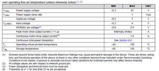

The datasheet shows 1.6-A Maximum Drive Current at 24 V and TA = 25°C.
If we use the VM is 12V, does it mean we can drive it reach 3.2A?

  • The datasheet shows 1.6-A Maximum Drive Current at 24 V and TA = 25°C.
    The 1.6A max output limit is due to the thermal limitation of the internal H-bridge FET, P=i^2 * R, where R is the FET on resistance, and not due to P=V * I. So even of VM is 12v the same 1.6A max is applied.

  • Thanks for your reply. I want to increase the maximum drive current from 1.6A to 3.2A on VM 12V situation.
    So, I want to confirm the Peak motor drive output current spec, but I found missed OCP function.
    1.6A is continuous output current, and it will trigger the OCP if the current is 1.8A or higher; therefore, 3.2A is a wishful unrealistic dream.
    Brian
  • Daniel,
    Our highest power stepper motor driver is the DRV8424 which has a min OCP of 4A.  This would technically meet your specification.
    Full scale current is still thermally limited to 2.5A.  If you need full scale current of 3.2A, you will need to consider a gate driver like the DRV8711 with external FETs.
