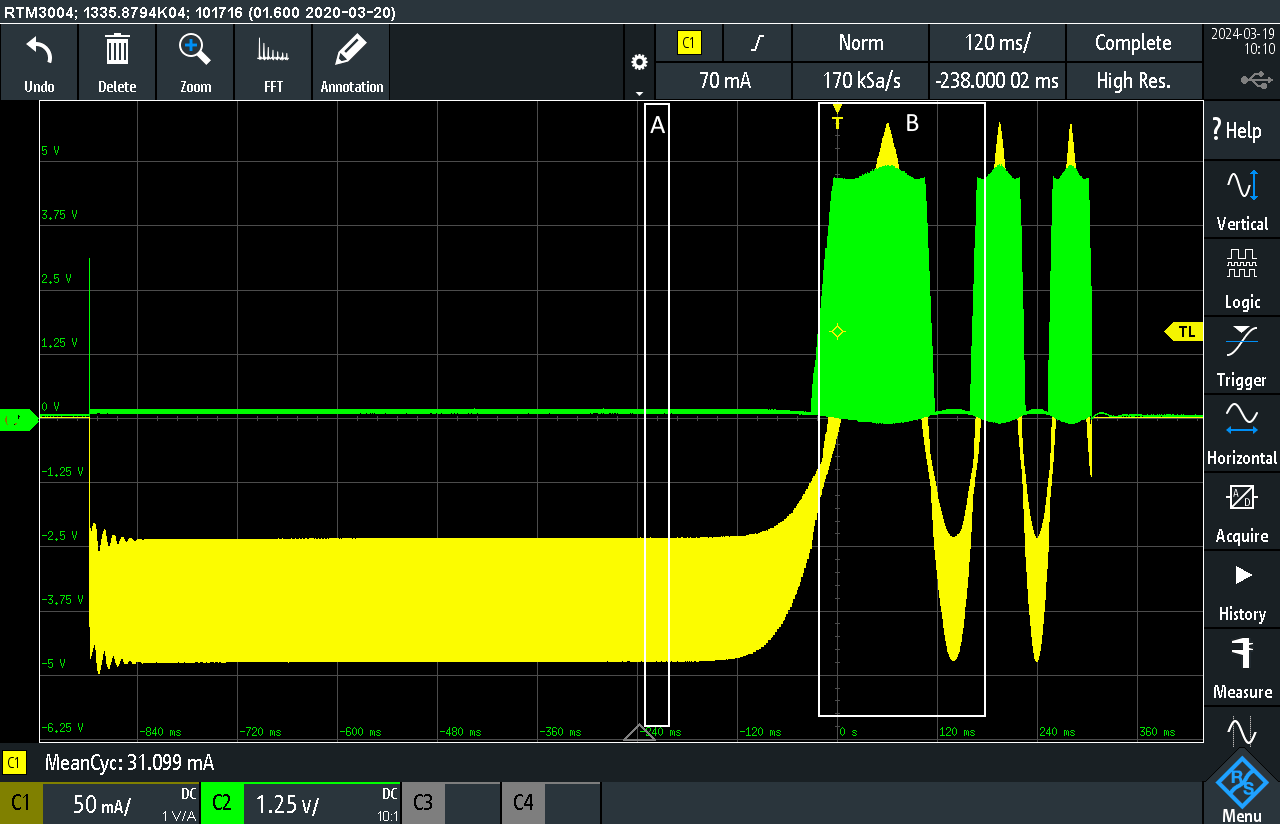

In my tests, the motor aligned, made a few steps and then it looks like it goes to a lock condition:
I tested also to replace the LEDs parallel to the windings (H101, H103, H104) with resistors (the 2k2 were replaced with 0 Ohm) of 24 ohms to draw at least a current of 100mA to not fall into the "no motor" lock. No success.
I also tested to set the CONFIG-Voltage to 0V and to VCC also with no success. The result is always the same as in the video....
By the timing, i would say, it falls into a lock but i dont knwo how to figure out which one and how to mitigate it....

  • Okay. i measured as you ordered.
    Yellow = Current on Coil a
    Green = Voltage on Coil a
    the first (longer part) is the alignment and then the few (slow) steps follow. After those steps, it goes to lock as it seems.
    The Details A and B:
    The details of C:
    For the kt:
    Details of D:
    So a voltage of around 422mV at around 379Hz betwheen 2 coils while i spun it by hand.

  • Hi Thomas,
    In the last image please correct me what I am reading. If we look at Y scale it is Peak to Peak as aprox 4V  (your comment as 422mV looks not proper)
    If we take as per Y scale (Assuming voltage probe attenuation is properly configured) the BEMF constant = Peak to Peak / (2* SQRT(3) * Frequency)
    Then BEMF Aprox 3mV and we can also verify from the data sheet provided, 4.3mV/Hz as per Speed constant 3450 RPM/V (Take inverse of it and convert to V/Hz with Pole Pair data).
    Sorry for more debug, can you capture the current waveform at the hand off point? I want to see the frequency it reached? The motor phase current becomes zero once motor reaches the hand off speed and re sync after measuring Kt.

  • Hi Venkatadri
    The hand off point looks like shown in the data sheet page #19
    I think my point doesnt get understood:
    - The scope i posted is ALL thats happening:
    - There is NO HANDOFF POINT reached before it seems to go in Lock
    - The Graph on Page 19 as you told, shows a waveform which HAS a handoff-Point (Change from open- to closed loop):
    This does NOT happen with me. It doesnt even reach this point. Doesnt come close. 3 steps on this one coil and lock. Page 19 shows like 50-70 steps till handoff....
    As posted multiple times: The Motor gets aligned, The motor starts spinning for a FEW STEPS. See Video in first post.
    Then it goes to lock. See Video in first post.
    If motor never starts spinning then some other issue.
    The motor works. I tested it multiple times in our Insulin pump, with a weird chinese Drone-Motor-Controller and even with a Arduino-DIY-Solution... The motor works on everything except on a dedicated BLDC-Controller here...
    Initially motor start spinning in open loop, after the motor speed reaches configured hand off speed device stops divining briefly, during that moment phase voltage will be of BEMF, device measures this BEMF and calculated Kt of the device.
    As said, as posted, as shown in video: The Controler gives up accelerating the motor after 3 steps.
    So I try to explain it AGAIN:
    - Motor seems to align
    - Motor makes 3 steps on one coil
    - Motor goes to lock
    - There is no handoff reached in this 3 steps of the motor (like 3/4 turn or something like this. See Video)
    - Motor works as confirmed by driving it with multiple different DIY-Solutions
    BEMF:
    To the previous question: You are right. The cursors were of another channel with factor /10.
    So the BEMF = 370Hz and Upp 4.22V
