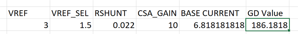

    Program GD CONFIG1 and GD CONFIG2 values for BASE CURRENT. In your JSON is 37.5A is used which is higher side.
    If you are using 22mOhm shunt in the HW then use below table
    CSA Gain of 10V/V and BASE CURRENT of 186 (0xBA)
    Also, close loop accel and decel is very high in the closes loop. Let us reduce it until we see stable running.
    Let us test MPET with changes to R shunt on the board and GD CONFIG registers.
