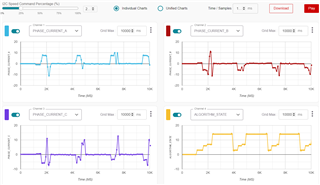

Hi, we are developing a medical device using a 24V BLDC motor (R=0,15ohm; L=0,12mH), peak current 10A. We managed to spin it with the EVM board and MPET without any load. The moment we applied a load appeared DRIVER_FAULT message.
Next step, as the peak current is 10A we have changed Rsense on the board to 0.004ohm, and set BASE_CURRENT=0x100. Now we are not able to spin the motor even without load, DRIVER_FAULT and OCP_VDS_FAULT message appears.
What might be the problem? CSA_GAIN=40, SEL_VDS_LVL=2.0V
thanks.

  • Hi Rafael,
    If the motor with load is not generating an OCP_VDS fault then I recommend trying to get the motor to spin without changing the sense resistor.
    1. With and without load, does enabling AUTO_HANDOFF_EN allow the motor to spin into closed loop aligned?
    2. Can capture of the phase current from startup to fault with the load be provided?
    3. Can a capture of the phase current from startup to closed loop without load be provided?
    4. If possible, I recommend hand measuring the BEMF constant of the motor using the instructions in section 7.3.14.3 of the MCF8329 Datasheet
    Joshua
  • Hi Joshua, find below the answers and the screenshots of phase currents with and without load:
    1)yes without load; and no, it can not spin into closed loop aligned with load.
    2)Screenshots named as "current_LOADx" (speed at 25%, 50%, 100%) ; motor can not spin.
    3)Screenshots named as "current_NO_LOADx (speed at 25%, 50%, 100%) ;
    4)hand meassured BEMF is 115mv/Hz
    also attached the json file, thanks

  • Hi Rafael,
    1. To see if the load can be spun with load, please decrease the open loop and closed loop acceleration down to 25 Hz/s and 20 Hz/s respectively.
    2. When loaded, does the motor settle before going into open loop? If it does not, please increase the align time so the motor has time to settle before entering open loop.
    3. When AUTO_HANDOFF_EN was disabled, did the motor spin for a while before the fault occurred or did the motor stall before the fault?
    Joshua
  • Hi Joshua,
    1) With Load: After decreasing the values for the acceleration, the motor still doesn’t move. The only difference is that the sound it makes is quieter. I am attaching photos of the phase currents and algorithm state at 25%, 50%, and 100% speeds.
    2) With load: After increasing the alignment time, the motor still doesn’t move. The only difference is that the sound lasts longer. We had 400ms as the base time and conducted tests with 750ms, 1s, 2s, 3s, and 7.5s. I am attaching a photo of the phase currents and algorithm state with the alignment time set to 1s, and accelerations set to 25Hz/s and 20Hz/s.
    3.1) Without load: The motor spun and didn’t stop.
    3.2) With load: The motor didn’t spin before the fault occurred.
    register2.csv

  • Hi Rafael,
    In the .csv that you provided I see that the base current is set to 0x400 and the CSA_GAIN is set to 40V/V. Please set the BASE_CURRENT to 0x100 so that the CSA will provide an accurate measurement of the phase current to the MCF8329A.
    For future captures, if you can use an oscilloscope with a current probe this would be preferred to get a better resolution of the phase current.
    Please try and increase the open loop current limit if the motor moves during align. If the motor does not move during align, first increase the ALIGN or slow first cycle current limit.
    Joshua
  • Hi Joshua,
    All of this test have been performed under LOAD, we will try to send you next time the captures on an oscilloscope.
    1) We have adjusted the BASE_CURRENT to 0x100 (Attaching graphs).
    2) We made this test with 5Sec ALIGN_TIME. We increased the align or slow first cycle current limit to 75% (Attaching a video, so you can check the sound and graphs), over 75%, the motor stopped making sound.
    3) After this, we tried increasing the OL_LIMIT, but the motor didn´t make noise, neither turn.
    Rafael
  • Hello Joshua.
    We have been able to solve the trouble, and make the motor spin with and without load.
    If we have any other problem in the future we will open a new thread.
    Thank you very much for everything.
