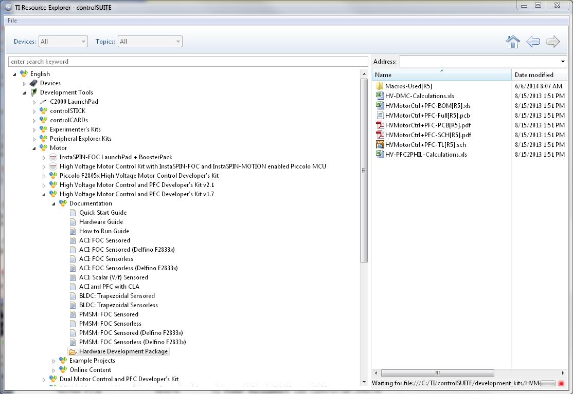

Where to find TMDSHVMTRINSPIN schematics?
Other Parts Discussed in Thread: CONTROLSUITE, MOTORWARE, TMDSHVMTRINSPIN, TMDSCNCD28054MISO, INSTASPIN-BLDC, POWERSUITE
I've installed ControlSuite and MotorWare but can't find the schematics for this open source kit..
I'm interested in seeing if (how) they are using the DRV83XX (<60V) for controlling 350V motor.
Thanks!
  • Hi Blipton,
    Please see POST  This one is old, so in case it does not work.
  • Thanks,  since that's the schematic for the PFC TMDSHVMTRPFCKIT Kit (Piccolo F28035 & Delfino F28335)..  is the output driver stage the same across all the high voltage kits, with just different control cards (TMDSHVMTRINSPIN (F28027F) or TMDXHVMTRKIT5X (F28055))?
  • Let us double check, but that does appear to be the case.
  • Updated information.  Please refer to LINK

    From a logistics point of view, it probably makes sense to have 2 high voltage kits (TMDXHVMTRKIT5X & TMDSHVMTRPFCKIT) that differ only in the control cards.
