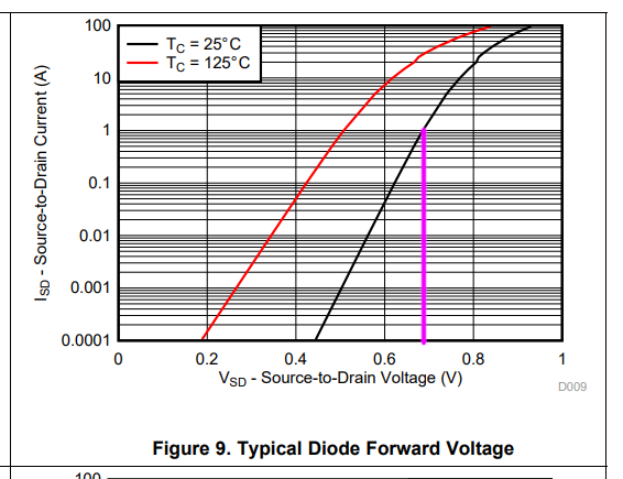

From the CSD18531Q5A datasheet we see the forward diode voltage is:
0.68V
Next we calculate the voltage drop over the sense resistor:
0.033 Ohms * 1.0 A = 0.033V
Now summing the voltage over both the sense resistor and the body diode we have:
0.68 V + 0.033 V = 0.713 V.
Ooops, we have violated the maximum ratings of the DRV8711 with the body diode forward voltage alone.
Are the absolute ratings correct for those pins? If so, how does TI recommend we stay within the absolute ratings when the vast majority of body diodes have a forward voltage of 0.6 V at 1A alone?

This appears to an oversight, neither reference design implement parallel schottky diodes and I would expect almost all applications to be using at least half an amp which exceeds 0.6V forward voltage on the CSD18531Q5A diodes chosen for the DRV8711EVM. The CSD88537ND FETs on the BOOST-DRV8711 reach 0.6V at an even lower current of 0.006A. None of the other designs I have seen referenced on this forum or available on the web utilize schottky diodes.
