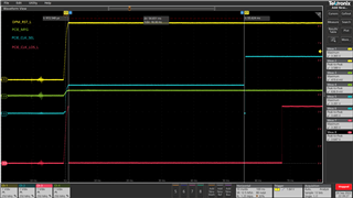

  • Hi Yihe:
    *PCIE_CLK_SEL is LGPO with logic "invert of PCIE_MFG".
    *There're two voltage dividers with same value and Rupper is connected to P3V3. PCIE_CLK_SEL is connected between these two voltage dividers.
    As first diagram shows, UCD90320 on my board took around 55ms for initialization.
    But if we zoom in, as 2nd diagram shows, it'll be low for around 380us.
    Is this a correct timeline?
  • Hi
    That's correct.
    During that 55ms, the IO is under Hi-Z, so you can see that the voltage is somewhere between 3.3V and 0. after the initialization, UCD starts to configure drive the IO based on the logic so it went low and back to high.
    Yihe
