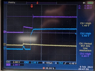

  • Mason,
    took pictures of the scope triggered on power up. Specifically, I triggered on VFB (Blue Trace). After a little while, it goes to zero. Blue stays the same in all pictures. Yellow is the Fault B trace. Pink changes. Pink in this one is not hooked up.
    For all of these, I hooked up one 27 volt, 30mA led rail to each of the 4 channels. I have a PWM signal going to the dim set to 10%, 5V peak, and 250 Hz .
    blue trace VFB, Yellow trace Faultb, Pink trace NA
    zoomed in time scale. Pink was on GD1
    Same zoom: Pink on the fet size of RD1
    same zoom: pink on the fet's source or SE1.
    Pink on the Vledfb test point
    Pink on Vdhc
    Other voltages:
    Vcc jumps to 6.24
    Thm+ jumps to 6.2
    Outp jumps to 5.8 but goes down to zero like Vfb
    EN goes to 5.04
    and sync stays at zero
    Thank you,
    Neil
  • hello Neil
    based on the waveform, it seems the device triggers open protection. As the waveform is not quite clear, can you help double below:
    1. there is a GD pulse during start-up, can you zoom in and check if it reaches ~5V?
    2.  does the voltage of FAULT_CAP reach 3V?
    3. modify channel of RISNS to 10mV/div and check if this keeps below 30mV
  • 2. FAULT_CAP does not reach 3V.
    3. RISNS1 through RISNS4 zoomed in.
    I was curious to see what RISNS1 would look like when I keep the eval board plugged in and turn the PS on using it's switch instead of already having the ps on and hooking up the banana plug. It looks like I have the same sharp voltage pulse at RISNS1 that I had before. But the voltage on the PS takes a few ms to reach 27V. So I think this is just noise.:
    1. GD1 with timescale zoomed in. I don't get anything over 200 mV on any of the GD's.
    Thanks again,
    Neil
