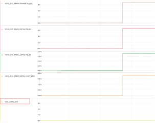

Q1) Is there a timing when FB_B3 and FB_B4 are powered or does this affect the operation?
(Wave Note, Same Timing as VSYS_3V3)

Why do you think this is affecting the operation? If VCCA measures 3.3V, then the safety FET circuit is working.
I previously asked about a scope shots of the VOUT-LDO on PMIC-A and PMIC-B. This would be the TPS65941120 and TPS65941421. Can the customer provide these scope shots? Please use a time and voltage scale that would allow me to check for noise.
