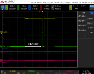

  • Hi Luis,
    Please see the attached plot showing when the OCD occurred.
    After the OCD trip, the C/DFET is turned off, and then roughly 10ms later, it is turned on again. We suspect that the bq76952 experiences a 10ms-POR, as evidenced by the log indicating that partial data is unreachable.
    However, we are unsure if our assumption is correct, as the bit POR in the Battery Status register remains unset after the POR event.
    Note: The ALERT pin in the plot can be neglected as we are currently not utilizing the ALERT function.
  • Hello Lin,
    That could be possible. We've seen similar cases when faults trigger. Do you have a schematic you could share?
    Luis Hernandez Salomon

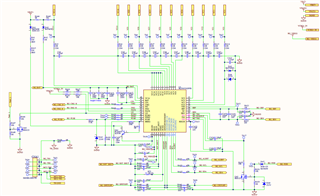

  • Dear Luis,
    Please find attached the circuit diagram related to the bq76952. Do you require any additional circuit diagrams or information?
    You mentioned that you've encountered similar cases before. Could you please provide me with the relevant issue numbers from the forum for reference?
    Additionally, based on your expertise, do you have any insights or thoughts on potential root causes for the issues we are facing?
    Chia Chun Lin
  • Hello Chia,
    Can you get a waveform capture of SRP pin with respect to IC ground(Vss) and SRN pin with respect to IC ground as well? If these were both to go high with respect to Vss during the turn-off, that may cause problems.
    I cannot recall an E2E off the top of my head.
    Can you share the FET circuitry? If you measure REG18 during this event, how does it look?

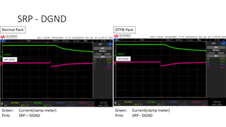

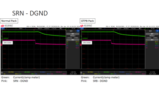

  • Hi Luis,
    Attached are the FET circuitry and signal plots.
    The timing captured in the plots indicates when the DFET is switched off.
    Here are the key observations:
    1. The behavior of a normal pack triggering OCD1 aligns with our expectations and is consistent with the behavior of the pack that did not trigger OCD1.
    2. REG18: No significant drop or pulse was observed.
    3. SRP - DGND & SRN - DGND: A voltage drop of approximately 200~300mV occurs when the DFET is turned off.
    We obtained an interesting test result during our investigation. When we externally set the RST_SHUT pin to HIGH for less than 1 second, causing a partial reset of the bq76952, and simultaneously polled the bq76952 via I2C for register status and analog data, we observed the same phenomenon (OTPB reset and partial analog data resetting to default values).
    Based on this, we suspect that the bq76952 might be entering a partial reset during the OCD1 test. However, the triggering event remains unknown. We are uncertain why the bq76952 is entering this partial reset state. What do you think?
    Chia Chun Lin

  • Hi Luis,
    I've got an update on our SRP/SRN ground test. Originally, the bq76952 ground was connected to "DGND", which is another ground in our system, instead of "VBAT-". This setup caused a voltage drop of about 200-300mV when the DFET was off.
    We tried shorting "DGND" and "VBAT-" to improve this. The voltage drop reduced to around 50mV, but the overall result remains unchanged from before the modification.
    Chia Chun Lin

  • Hello Chia,
    What is the voltage division of the waveforms? What are the voltages here? It is a bit hard to see.
    I understand, that is not good, BQ76952's ground should be near BAT-. Usually we connect the high current path of BAT- with a net-tie to the low-current path of the IC ground.
    Something I notice from your images is that SRP seems to be going below ground, how low is this going? Is it also possible to see what is the RST_SHUT voltage throughout this sequence?

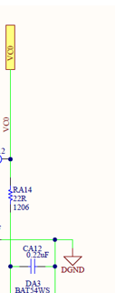

  • Hello Chia,
    Do let us know how the test goes with the diodes!
    Oh, I just noticed VC0 is connected directly to the AFE Vss.
    This is actually not usually done. We do not connect VC0 directly to Vss typically, it connects through the device's Vss through the filter resistor, in this case being RA14. You can see our EVM schematic for reference. During this test, did you measure the VC0 pin voltage compared to DGND/Vss?
