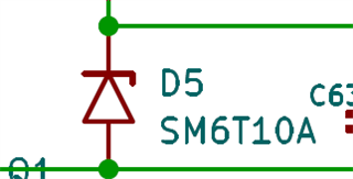

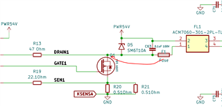

    1. I would recommend placing the slow blow fuse between your FET and the 47ohm drain resistor. This provides better protection to the actual IC.

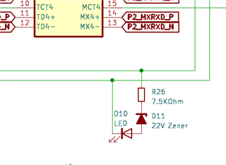

    2. If running compliance, add a jumper selection between your LED and low side. The LED current consumptions sometimes can cause Sifos failures if running compliance only.

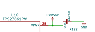

    4. Add .1uF bypass cap per datasheet requirement on Vpwr
    5. SM6T10A is not rated for PoE operation. TVS needs to be a minimum reverse standoff voltage of 58V and a max clamping at 95V.
    6.Self check Q1-Q4 meet design requirements:

    1. Check your bypass cap on Vpwr, should be rated for 100V, 50V is not sufficient.

    4. If you do not plan to use LED's for PG signal, you can DNP. If you wish to keep I recommend keeping jumper as the current consumption for the LED can lead to not passing compliance. So if you wish to run compliance you can remove jumper.

    1. Thank you for catching the 50V by pass capacitor. Changed it to 100V.

    4. I am not sure if I understood this correctly. I thought JP49 (opened jumper) would help serve this option. Where the jumper can be used to connect or disconnect the LED

    4. JP49 can be used to disconnect or connect the LED if used. I misunderstood the schematic as it showed the jumped, but showed as DNP, therefore this is good.
