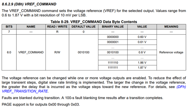

PMBUS command can sets the VREF
Burn the program into EEPROM before assembling the IC

    This PMIC are using for TL10(Marvell), pls check the attached file for the design details, as you know, the default vref=0.8V, we want keep the vref=0.8V for SW1, SW2, SW4, and change VFB3 vref to 0.7V.

  • Hi Rich,
    Please find below guidance about how to set Vref for each rail:
    The page command provides the ability to configure and monitor multiple outputs on a single TPS65400.
    The Vref_command sets the voltage reference for the selected output.
    Thanks!

  • Hi Lucia,
    My xml file as attached file : TPS65400_U12O521.xml
    sw1 vref : 0.8 V
    sw2 vref : 0.8 V
    sw3 vref : 0.7 V
    sw4 vref : 0.8 V
