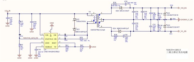

Hi team,
Could you please help review below schematic and give some suggestions? Thanks!

Hi Ivy,
See below my schematic review:
1. Rfb: I recommend decreasing this value to ~123kohm as recommended by the calculator. Rfb sets the output voltage from a voltage divider from internal VREF from the switching node, so it is very important to set correct Rfb value for good regulation at Vout.
2. Cout1: I recommend adding a 2.2uF 50V cap at output1 to meet low voltage ripple.
3. Cout2: I recommend adding a 4.7uF 15V cap at output2 to meet low voltage ripple.
4. The rest of components look good. Just keep in mind that at VIN_min 10V, the Poutmax is ~10W, so the output power might be limited at that value. For VIN nomial 12V, max power is ~12.2W, which should be good enough for your load conditions (11.25W).
