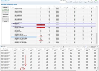

We have a 13S battery designed using the BQ76952 and are communicating with it over I2C using the EV2400.
Running into an issue with the cell-balancing. Following are the cell-balancing settings in the device memory:
I had increased "Cell Balance Minimum Delta (Charge and Relax) to 250mV (instead of the 40mV default). Not sure if that's the right way to go about it?
I'm attaching below the logs of individual cell-voltages for the cells. You can see how the voltages keep dropping. Draining the battery over time. The PACK voltage went from 52V to 49V.
While draining of the battery at this rate is a major concern.
The other issues is, the BMS doesn't stop draining, it doesn't reach equilibrium. You'll notice in the file below, Cell# 2, has been inherently at a lower voltage (compared to rest of the pack). The BMS allows Cell#2 to drain as well. I was initially assuming the balancing algorithm might allow all the batteries fall down to the voltage of Cell# 2. But if it's allowing even the lowest cell to loose it's energy, it'll drain all the cells and ultimately kill the battery.

    From the data you shared, there seems to already be a large difference between Cell 16 and Cell 2 (~483mV). With this large of a difference it can be more difficult to balance out, especially if there is a load. The batteries could be discharging faster than it can be balanced out.
    Can you try using the subcommand, CB_ACTIVE_CELLS() and take a log of this to see if it’s actually attempting to balance? Table 10-1. Host-Controlled Cell Balancing Subcommands in the BQ76952 Technical Reference Manual can help with that.

    In the meantime, updating you on my current status. This morning I found the battery turned off (I believe because it probably triggered the CUV protection for Cell #2, as it was below 2.5V and the overall stack voltage was below 48V). At that point, I charged the battery and gave stricter limits on the cell-balancing. Mainly to avoid cell balancing and see if the battery would still loose power. I'm attaching the logs here for your review. You'll notice the "Cell Balancing Active Cells" and "Cell Balancing Processing Time" is zero. As it doesn't get triggered. But, unfortunately, the battery continues to drain it's power. Not sure why?

    Is the device still on in SLEEP mode or is it SHUTDOWN mode? Also, could you measure the currents on the board? It is unusual to see the battery draining that quickly.

    I don't think the battery is in SLEEP or SHUTDOWN mode. As I had enabled the "ENABLE_ALL_FETs" command. Not sure if it triggers SLEEP mode after that?
    But, I realized, I had the EV2400 and an external power meter connected to the battery in all my tests. I removed both of them, and let the battery sit idle by itself for 3-4 days. I notice it dropped only by 0.02V per 24 hours (compared to the 2V per 24 hours). The EV2400 logging and the power meter were probably the main cause of the battery drain. I believe, with some more tweaking of the registers, the performance can be improved.

    The ‘ENABLE_ALL_FET’s command should not trigger SLEEP mode in itself. SLEEP mode can be entered through a command or if there is low enough current detected if SLEEP mode is enabled. 0x12 Battery Status()[SLEEP_EN] bit indicates whether the device is presently allowed to enter SLEEP mode or not, while the 0x12 Battery Status()[SLEEP] bit indicates whether it is presently in SLEEP mode or not.
    I’m glad you were able to determine that the EV2400 and external power meter seemed to be draining the battery.
