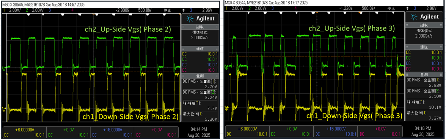

  • At Vin = 25 V, Vout = 15 V, the output current can reach 70 A.
  • At Vin = 40 V, Vout = 15 V, we are able to test up to 60 A, but at 70 Athe overcurrent protection is triggered and the output voltage cannot be maintained.

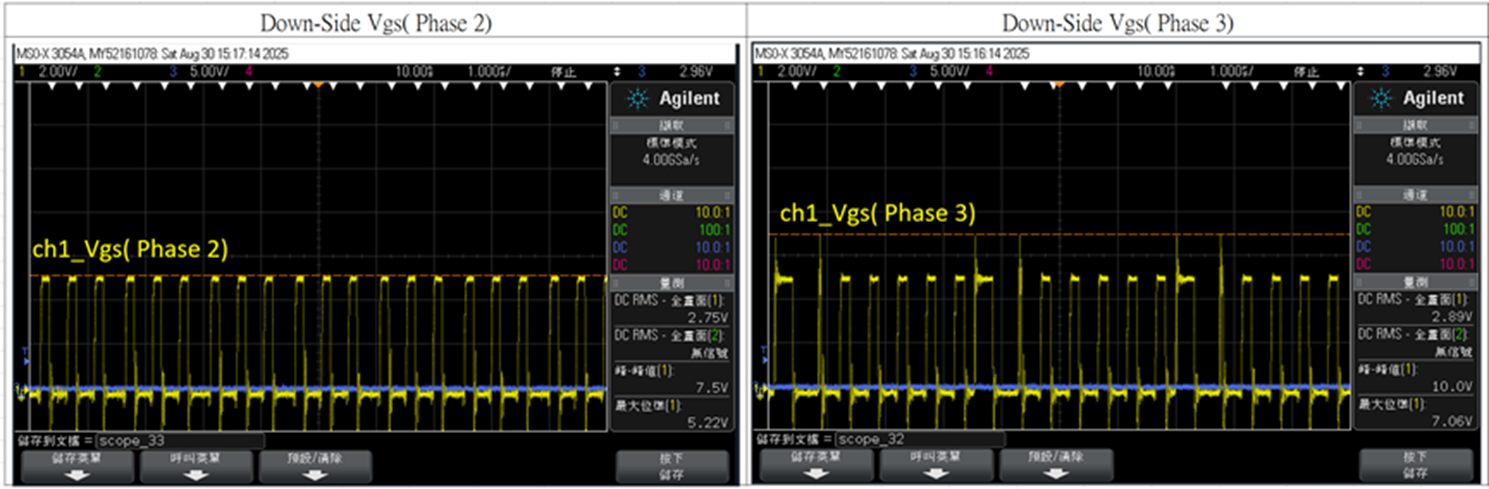

  • At Vin = 50 V and Vout = 15 V with no load, we observed an abnormal temperature rise on Phase 3 exceeding 100 °C. We measured the Vgs of the Phase 3 down-side MOSFET as shown in the figure below. For comparison, the Vgs of the Phase 2 down-side MOSFET shows a normal duty variation, while the Vgs of the Phase 3 down-side MOSFET exhibits abnormal duty behavior. We are not sure why this variation occurs. Or are there other possible causes?
Could you please advise how we can improve this?

    During testing, we observed the following behavior:
    • With Vin = 50 V and no load, Phase 3 shows a high-temperature condition when the secondary IC is configured as Mode = VDDA, FB1 = VDDA, FB2 = VDDA.
    • When we configure the secondary IC as Mode = VDDA, FB1 = AGND, FB2 = VDDA, all four phases enter DEM mode at no load, and Phase 3 no longer exhibits the high-temperature issue.

  • Hello Yuming,
    The primary controller’s DEMB pin determines whether it operates in DEM (Discontinuous Conduction Mode) or FPWM (Fixed-Frequency Pulse-Width Modulation). The secondary controller uses the FB1 pin to select its operating mode.
    In your configuration, FB1 is connected to VDDA, forcing the secondary controller to operate in FPWM mode. This results in higher losses in phase 3 compared to the other phases.
    I would suggest operating both controllers either in DEM or FPWM
