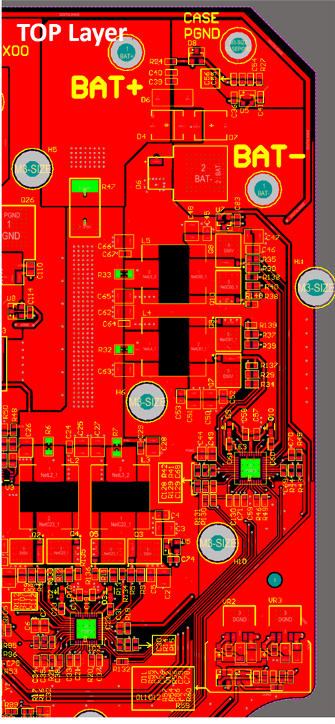

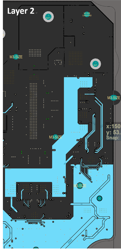

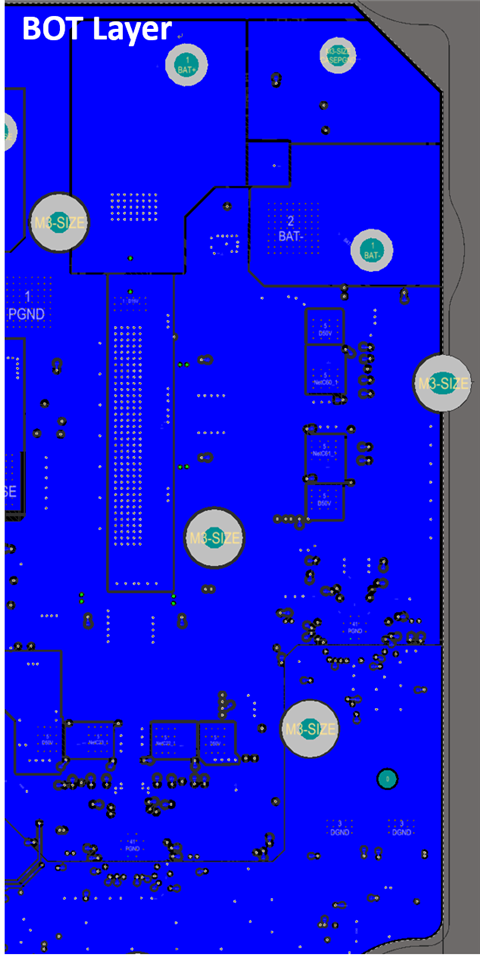

    We would also like to share part of our PCB layout for your review. The design is based on a 4-layer PCB, with all components placed on the TOP layer. The 50 V input (Vin) is routed on Layer 2. For thermal management, the PCB is mounted to an aluminum enclosure with thermal paste to aid heat dissipation.
    During testing at an ambient temperature of 24 °C and Vin = 50 V, the maximum load current we can achieve is 48 A. At this operating point, the MOSFET case temperature reaches approximately 135 °C.
    Could you please advise on what modifications or improvements—such as PCB layout optimization, thermal management enhancements, or MOSFET selection—would be necessary to achieve 70 A load current at Vin = 50 V?

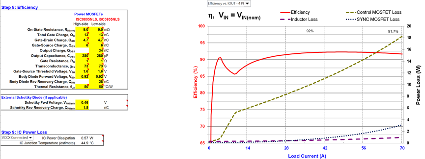

    After inserting FET parameter in the QuickStart estimated efficiency looks quite poor.
    here are some suggestions on optimization
    1. Reduce Rg to 1 Ohm or lower
    2. Bottom FET with lower Rds on could be chosen or two FETs can be connected in parallel
    3. Switching frequency can be reduced, however output filter and compensation will need modification accordingly

    We are currently using the ISC0805NLS MOSFETs, and the calculated efficiency is shown in the figure below. At present, the gate resistors for the high-side MOSFETs have been adjusted to 3.65 Ω and 0 Ω, while for the low-side MOSFETs, both gate resistors have been set to 0 Ω.
    Our design target is to achieve 15 V / 70 A output with Vin = 50 V. However, in our current testing at ambient 24 °C, we can only reach a maximum of 48 A load, at which point the MOSFET case temperature rises to about 135 °C.
    We would like to ask for your support in reviewing our PCB layout. Could you please advise if there are any areas where the layout should be improved to help optimize thermal performance and enable us to reach the 70 A load target?

  • Hello Yuming,

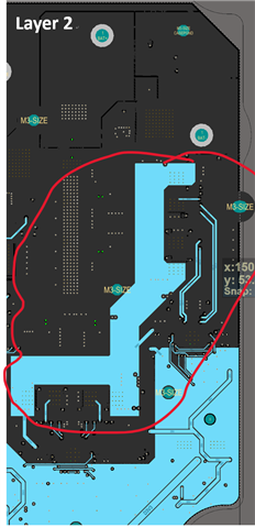

    To improve heat dissipation, I recommend increasing the area of the VIN power plane on Layer 2. Additionally, consider increasing the PCB layer count to six layers and using a copper thickness of 2 oz. What is the current thickness of copper in your PCB?
    High efficiency is critical for achieving for managing better thermals. With an efficiency of 91%, approximately 100W of power will be dissipated into the PCB, which is substantial for a four-layer board. Even a small improvement in efficiency can significantly reduce thermal stress – for example, a 2% increase would reduce losses by 20W (0.02*15*70 = 20W).
