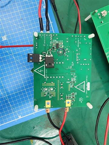

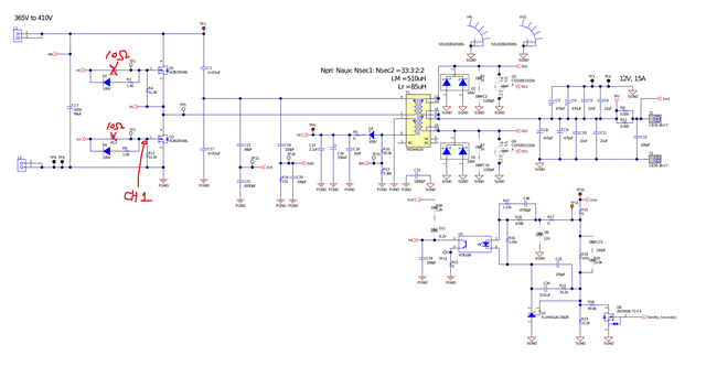

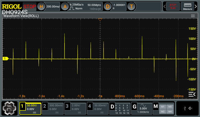

I am designing a 550W battery charger using the UCC256403, referencing PMP40766 as a design guide.
The intended output specification is 39–58V / 9A.

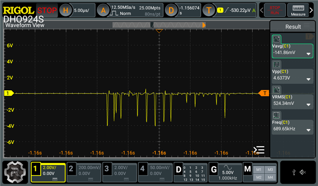

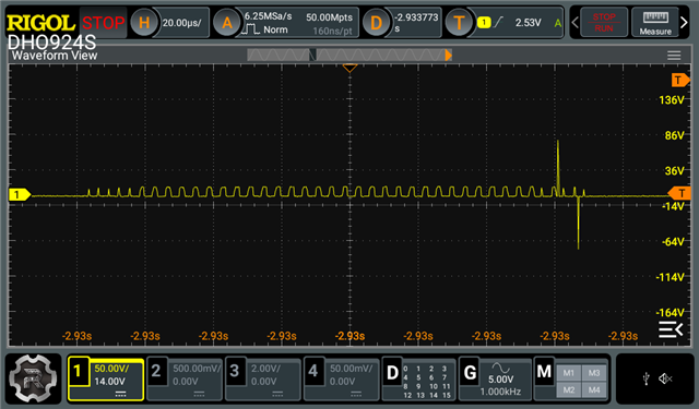

I have fabricated the first prototype board and applied power; however, the output does not reach the expected level. When power is applied, the output voltage slowly rises to about 30V over 20 seconds and stabilizes around 30–36V only.

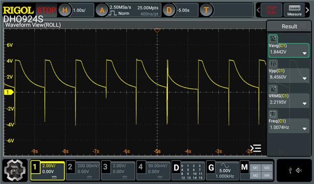

When I measured the Lr node, I found that the switching occurs at a very low frequency, around 1Hz. I have carefully reviewed my schematic but cannot identify the cause of this issue.

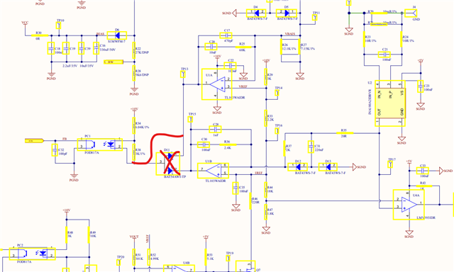

Could you please review my schematic and help identify what might be causing this problem?
I have attached the schematic and design materials for your reference.
Thank you very much for your support.
