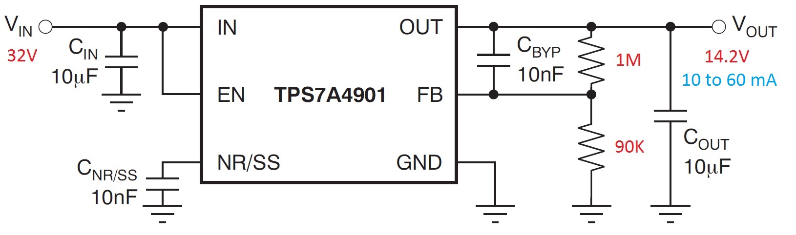

I have a problem that I can not find solution. I used the LDO's TPS7A4901 and the TPS7A3001 regulators to make a complementary power supply. The schematic and the PCB are the same for both LDO. Are the typical datasheet schematic :
The negative part with TPS7A3001  work successfully with zero problem, but the positive part  with TPS7A4901   work for maximum 5/10 minutes whit an unstable output range (12 to 14 Volt) and after  it destroys!! I have solderet five PCB's and i tried to change the ratio resitances (R1= 470K R2=47K), but all give roughly the same problem!!!
Could you help me to solve the problem? thing is that it changes from a negative to a positive LDO? What changes from a negative to a positive LDO?

  • HI Ryan,
    i don't have in this moment a scope measures, but the test value are:
    VIN= 32Vdc  VOUT=14Vdc. In my five test i have i used a  constat load with a 470 ohm resistor (at 14V IOUT= 30mA)
    This is my simplified dual power supply used for TPS7A49 and TPS7A30 test
    thank you.
  • Hi Alessio,
    which kind of capacitor do you use for input decoupling ?
    Are they ceramic / low ESR ?
    Best regards
    Stefano
  • Ciao Stefano,
    i use Aluminium Polymer cap with very low esr.
    bye
  • Alessio good morning,
    I take a look to some datasheet because I don't know this kind of capacitor.
    It seems to me that they are not suitable to replace a Ceramic capacitor; please check Impedance-Frequency characteristics of your capacitor.
    "LOW ESR and Z" have different meanings for the different kind of caps. Is better to check numbers on datasheets.
    Another concern is about voltage of your cap; they are 50 V rated ? Please remind that capacitance become low when bias voltage increase.
    Stefano
  • Thank you Stefano...
    The Caps that use are CONDUCTIVE POLYMER ALUMINUM SOLID ELECTROLYTIC CAPACITORS 10Uf 50V with ESR=50mohm. The datasheet of TPS7A49 says only that:" to ensure stability, maximum ESR must be less than 200mohm" . So I guess it's all right!!
    Anyhow I remember you that the negative regulator TPS7A30 with same PCB, same components, same conditions, works perfectly!!
    bye
    Alessio

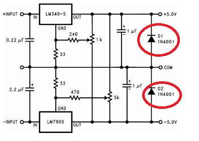

  • Possibly a problem with start-up, especially if negative Vout starts first and pulls positive Vout pin below ground.
    Fix for bipolar regulators was adding diodes across each output to prevent reverse bias.
