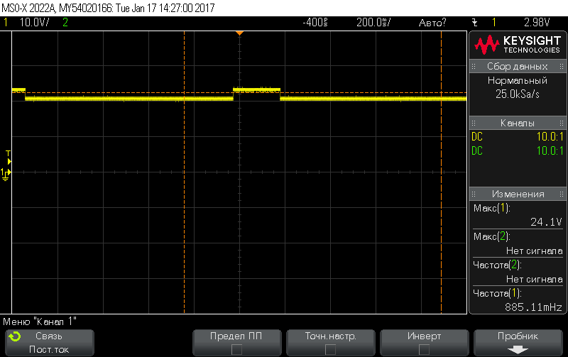

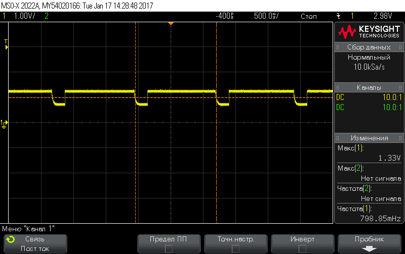

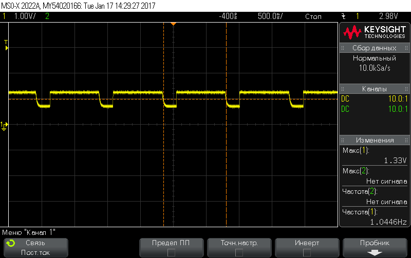

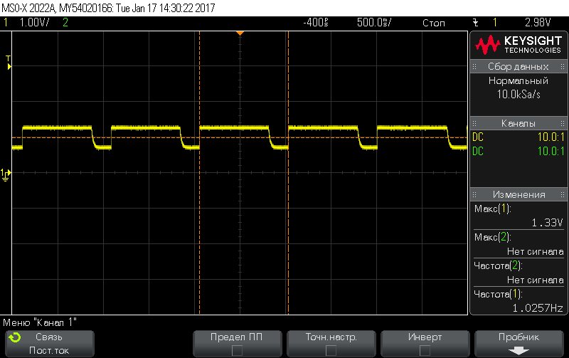

  • There are oscillograms without battery.
    VCC
    SNR
    HIDRV
    REGN
    When battery is connected BQ24610 working in short circuit mode (only low side switch are operating).
    Vin = 25V, Battery - 21V @ 1.6A.

    I think the problem here is that not only does the IC looks damaged, it would also seem that another component of the power stage may have gotten damaged. Please check the bootstrap cap, the bootstrap diode, the high side FET, the low side FET, input cap and output cap.
    In the scope shots looks like battery detection pulses, but also REGN should not have that waveform. It should always be stable 6V on REGN. See if you can desolder the IC and measure continuity on REGN with other pins to see if it is shorted.
