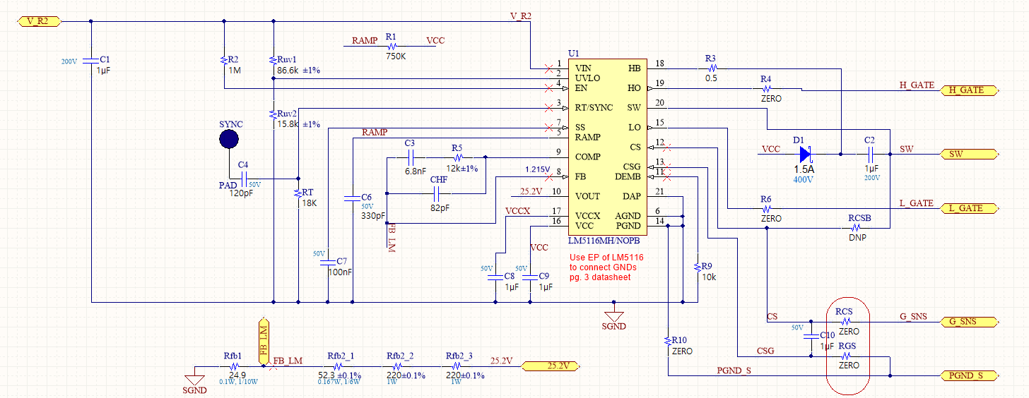

  • Hello David,
    Thank you for taking time to take a look. We are trying to get 25.2V output and up to 20A. We are using 2 separate boards for the driver and MOSFETs connected through board-to-board headers. We used 2oz copper for the driver board and 4oz copper for the MOSFET board for heat dissipation. I mention this because one of my concerns is signal delay / integrity from using headers. Below are the two schematics, hopefully the port naming should be translatable.

  • Hello Phil,
    I checked your schematic, and I would like you to remove C10, if you are going to populate C10, make sure its no greater than 1nF and when insalled you need to have RCs and RGs installed, make them 100ohm each.
    Change RFB1 from 24.9ohm to 1k and caluclate the FB resistors from there...
    Change C6 from 330pF to 2nF
    Change Rramp from 750k to 100k
    Change R5 and C3 from 12k and 6.8nF to 10k and 22nF respectively.
    Change L1 from 2.6uH tot 22uH
    Can you check to see if things improve?
    Your concern regarding the Gate drive is understandable. I would check the timing and compare the outputs of the Device to the output to the gates of the FETs. You can place RC's delays (with a Back Biased Diode) to the inputs of the driver, to ensure you dont run into issues. You can then tune the RCs accordingly, if needed?
    hope this helps?
    kind regards,
    David.
  • Hello David,
    I was able to make most of the changes you recommended:
    1. Removed C10
    2. Changed Rramp to 100k
    3. Changed R5 and C3 to 10k and 22nF
    4. Changed Rfb1 and 2 to 1k and 15.8k, respectively (this reduces Vout to 20.4V)
    However, due to space constraints and immediate availabilty, I am unable to increase the inductor with the desired current rating. I have instead replaced L with a 18uH / 1A inductor for testing, and C6 has changed from 330pF to 1.2nF. Because the inductor is only rated for 1A, I have put a 33 Ohm load at the output to limit the current.
    We also increased the switching frequency from 180kHz to 300kHz (by reducing Rt to 10k), and saw some improvement.
    I did check the timing between the gate output of the driver and the gates of the MOSFETs and found there was no noticeable delay, so the use of the headers to connect the driver to the rest of the circuit does not seem to be an issue.

  • Hello Phillip,
    Thanks for the response.
    Have you followed the layout guide lines in the datasheet.  To make it easier for you.  Please refer to the attached and let me know if the layout is in accordence with the recomendations therein?

  • Hello David,
    The layout guidelines in the datasheet were followed as closely as possible, but I was unaware of the additional floorplan.
    There are a few small variances from the floor plan you linked:
    1. Vcc GND is not connected directly to PGnd, but connects directly to the EP, which connects to both AGnd and PGnd.
    2. Vsw is not as small as it could be, but it is not large either.
    3. CSG is connected to PGnd locally, on the separate driver board and not directly next to the Rsense by the MOSFETs.
    4. Rsense/MOSFET loop is not kept small/tight.
    5. Lastly, Vin has aluminum caps for most of the capacitance, and one ceramic cap right next to the driver.

  • For those that happen upon this thread looking for answers, communication with David proved successful in answering question we had regarding the LM5116 operations.
    There were a few smaller issues regarding PCB layout (highly recommend following the floor plan posted above), but three issues stood out as the key elements in the solution.
    1. Keep the MOSFET / Rsense / Cin loop as small as possible (see floor plan)
    2. Output inductance was too small, stick to recommended ratings.
    3. LM5116 can only supply limited current for Vcc. For most designs this is not an issue, but if you require MOSFETs with a sufficiently larger Qg, check the average current required to drive the gates. If you are over the limit, use an external Vcc; one of the reference designs on the LM5116 page uses this approach.
    Thank you David for all your help.
