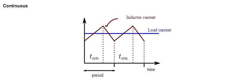

May I know why inductor current is not starting from zero for a buck converter.
Please find the attached wave from.In the inductor current waveform equation there is a term for time .Whet T=0 it shoud start from zero ,but the waveform is different.
May I know why.
Hari
ΔI+L=(Vin−Vout/L)*ton=(Vin−Vout/L)*DT

  • The time zero in this waveform is the beginning of a switching cycle. It is not the first cycle when the buck converter is starting up. The waveform is a steady state waveform in continuous conduction mode, when inductor current waveform is the same triangal shape every switching cycle. The DC (average) of the waveform is the same as the load current. The peak to peak ripple is dependant on Vin, Vout, L and switching frequency. The equation should be ton*(Vin-Vout)/L
  • The peak to peak inductor ripple current equation is ILp-p = (Vout/Vin) * (Vin - Vout) / (Fsw * Lout). And yes the waveform you reference is the steady state operating condition, not a start up waveform.
