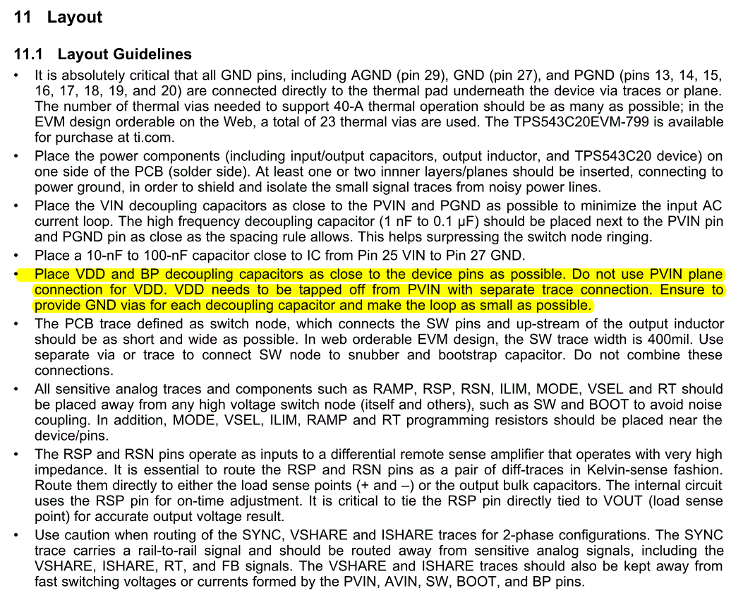

In Rev. B, a capacitor of 10 to 100 nF is recommended for Pin 25 (PVIN) to Pin 27 (GND).
In the layout guideline, it is recommended to place it as close to the IC.
However, to place the decoupling capacitor of Pin 26 (VDD) to Pin 27 (GND) as close to the IC is also recommended .
How should we place a small capacitor of Pin 25 to Pin 27?

  • Hi John-san,
    I'm sorry for bothering you.
    According to Datasheet P.33, it says "Do not use PVIN plane connection for VDD".
    I think that the proposed layout does not conform to this description. Is this a problem?
    Yuto Sakai
  • Ok then run a separate trace for it. I am not personally convinced it is that critical, but it is always best to follow the data sheet recommendation. I will edit out my previous posts.

  • Hello Sakai-san,
    My name is Kit Nguyen. I am supporting this device and able to help you further. John had forwarded all the information and has been communicating with me internally Ti.  I understand your questions on VDD bias capacitor and Vin bias capacitor.  Here are some feedbacks:
    1. Vin capacitors:
    1a) I saw you already a small capacitor which next to pin 20 and 21. This capacitor (pin 20/21) has more priority to reduce the ringing on the drain to source of both upper MOSFET and lower MOSFET.  Also, this capacitor will also reduce the ringing spike during the turn-off of upper MOSFET.
    1b) Pin 25 to 27 capacitor: this capacitor will help to reduce the duration of ringing. Please see attach waveforms for comparison with and without 10nF at those two pins. The waveform shows Vin to SW voltage during turn-off of upper FET with 12Vin/0.9Vin/500kHz/35A conditions (Blue trace--No 10nF at pin 25/27; Red trace--10nF at pin 25/27). This capacitor will help reduce the Vds-SW voltage.
    2. VDD capacitor: The purpose of this capacitor is supplying the charge to the VREG (output of LDO) and an input of LDO. I suggest to route the GND of this VDD capacitor to the pin 26 directly as the shortest distance to thermal pad. Can you use this cap as same as in the EVM user guide  CAP, CERM, 1 µF, 25 V, +/- 10%, X5R, 0402 (Murata GRM155R61E105KA12D)? This capacitor can be place next to pin 25 and 26. Then pin 25 to 27 capacitor.  From your placement layout, it looks like there is enough space between IC and pin 25/27 capacitor for another 0402 cap. Also, the ground side VREG capacitor needs be same ground plane as those capacitors as drawn suggestion.
    Questions: What is your design condition: Vin, Vout, output current and Fsw? I can guide you further to better optimize the layout.

  • Hello Sakai-san,
    Since the output current is only 11A, you can put Pin 25/27 capacitor at bottom layer.  And, place VDD bias capacitor next to the IC at pin 26/27. Also, TI has released 25A version (TPS543B20) of this family.  TPS543B20 has 25V FET rating in comparison with 20V FET rating in TPS543C20.

  • 7356.Doc1.docxHello Sakai-san,
    I was not clear enough in the previous document file on the layout of those capacitors.
    If the customer can use 0402 size for VDD capacitor, this capacitor can be next to the pin 26/27. Then, the trace connects to VDD can be bottom or internal layer and via up to connect to the cap. As result, no trace go through the Vin capacitor. Please see attach picture.
    If the customer can not route as suggest above:
    Vin=12V,Vout=0.72V,Iout=68A(2Phase),Fsw=500kHz: place the Vdd cap at bottom layer and Pin 25/27 next to the IC. Please allow ground side of VDD cap and Vin pin 25/27 cap join together through at least 2 vias with GND plane.
    Vin=12V,Vout=1.2V,Iout=22A,Fsw=1MHz : Place pin 25/27 cap at bottom and Vdd cap next to pin 26/27. Please allow ground side of VDD cap and Vin pin 25/27 cap join together through at least 2 vias with GND plane.
