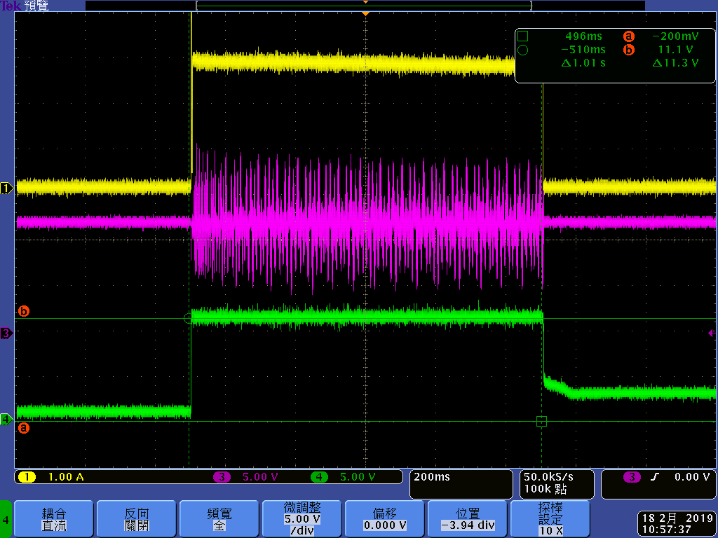

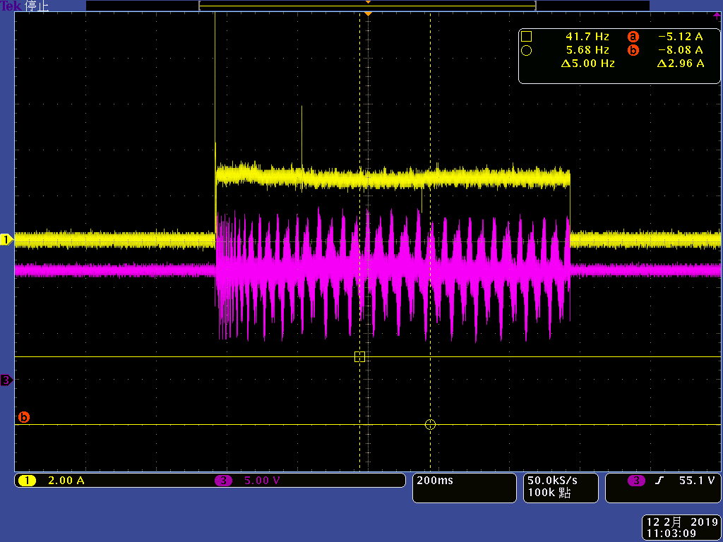

Could you please why EVM board which VIN pin have noise (Due to our customer board also have this kind of noise)
Warm Regards,
Lin
Dear Sir,
I can't see clear what is the voltage grade of the input voltage. Could you please upload a more clear picture?
By the way, what is the load conditions and what is the output voltage during this time, has the output voltage rise to a stable value?
Hi Tony,

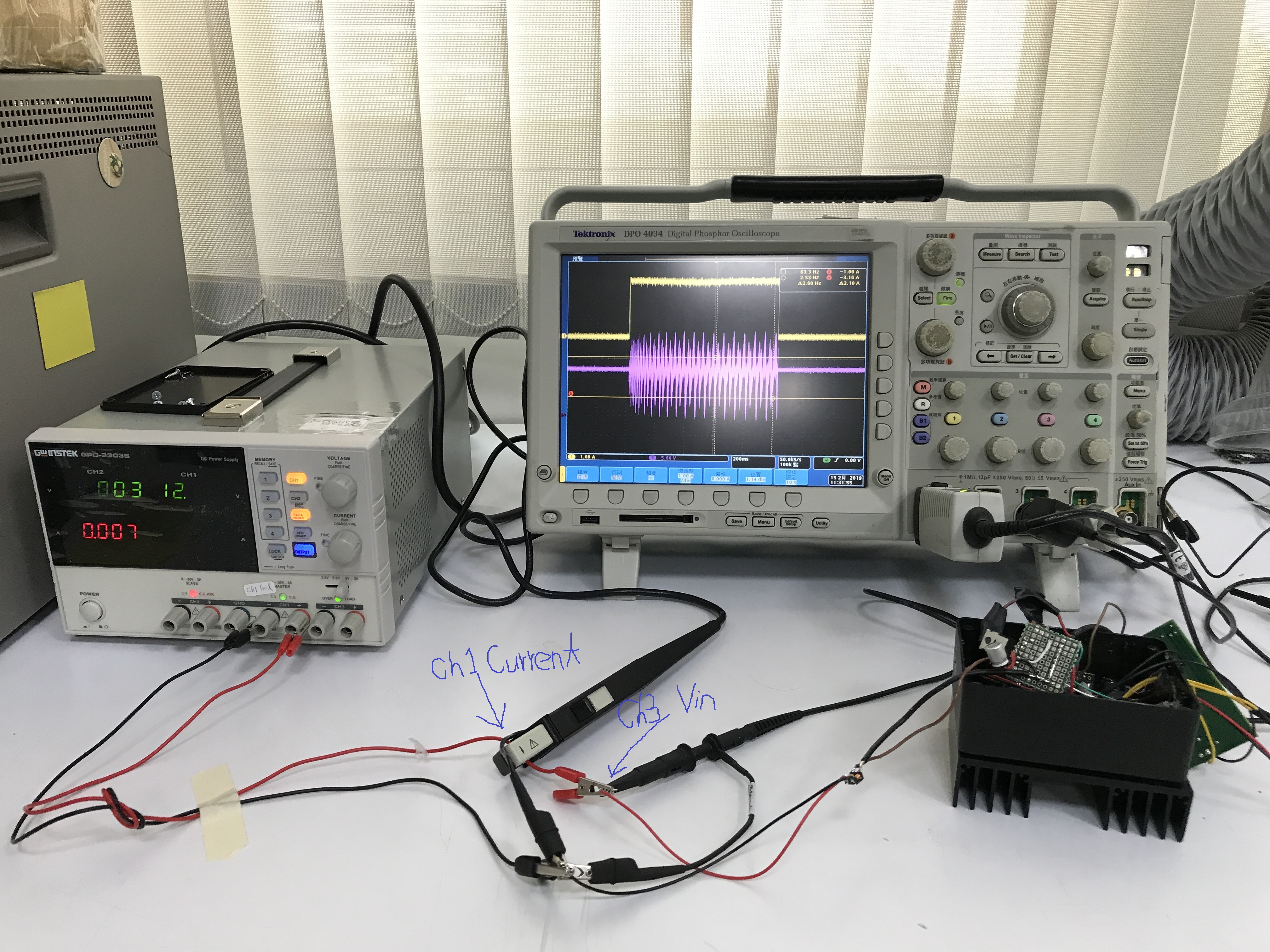

I'm pretty sure there coupled lots of noise from the switching node when testing the Vin voltage. How did you test the Vin voltage, could you please send a picture to me?
Dear Tony,
Thanks for the sharing. the test loop is really too big. please test this on the pcb board and just across the input cap, it will be much better.
And by the way, it seems you add an inductor before connecting the to the board, right? if so, please remove this inductor, it will introduce resonance into the circuit.
