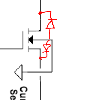

I have a question about TPS25221.
This device has reverse current blocking when disabled.
Could you tell me this detailed operation?

    The substrate of the switch MOS tube inside TPS25221 is independently grounded, so its body diode is a pair of reverse diode when Disable, so it has the ability of reverse current protection.

    The part uses back to back MOS structure as following shown.
    Apply Vin=3v and Vout=5V to creat the reverse condition.
    As disabled, Mos will turn off.  Due to we use back to back structure, the reverse current will be blocked by the parasitic diode.
