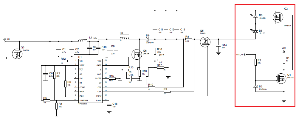

Project 2:
Input:
Vin: (Min: 6V-Typ: 12V-Max: 16V)
Output:
2 LEDs in series, but sometimes only one will be active or both will be active. For this I will use a FET.
VLED: (Min: 11.6V-Typ: 13.6V-Max: 14.8V)
Vout with 1 LED active: (Min: 11.6V-Typ: 13.6V-Max: 14.8V)
Vout with 2 LEDs actives: (Min: 23.2V-Typ: 27.2V-Max: 29.6V)
I LED output current: Typ: 1A - Max: 1.2A

    Would you have any examples of how to use the FET so that the time to turn the switch on and off does not affect the LEDs?
    The way I connected the FETs in the image would work? The values of the components have not been calculated yet, please consider only the red link that refers to the switch.
  • Hi Josnei,
    This is a little bit beyond the scope for E2E. In general, your circuit will not work at all. VCC will always be lower than Vin so you will never be able to turn ON you Q2 FET if it's an N-Channel. I suggest you educate yourself on how FET's works and how to slow the switching times down.
