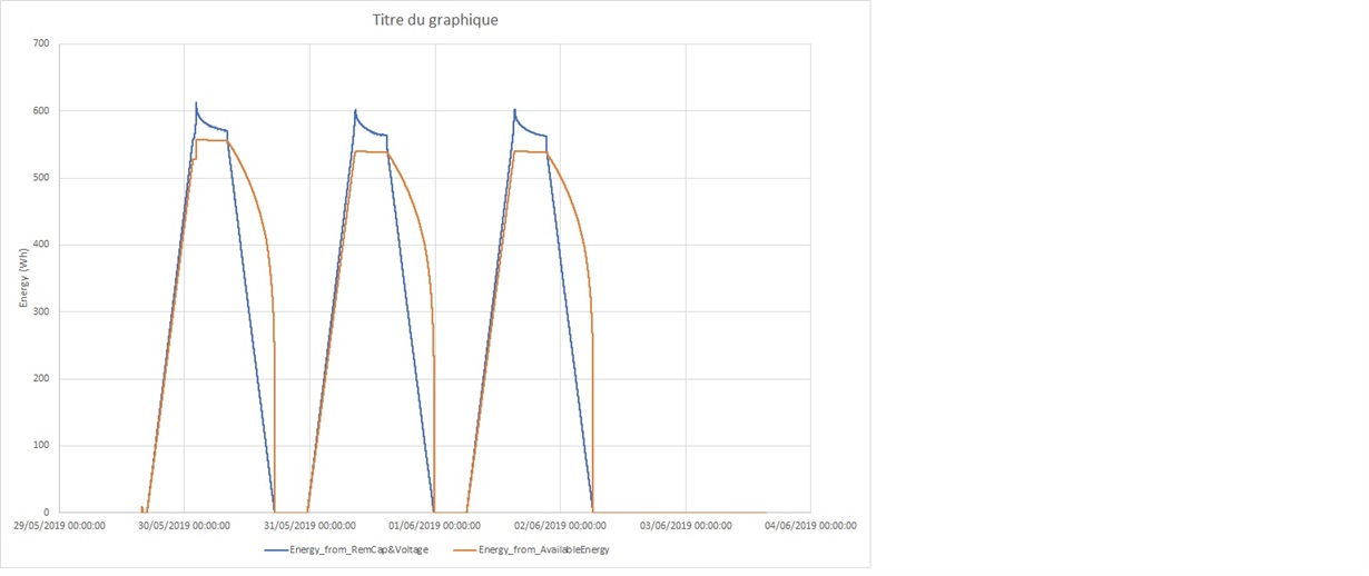

I am faced with a strange behavior of the Available Energy counter, during battery charge only. The value seems to wrap, it suddenly becomes negative, then, most of the time, becomes positive again before the end of charge. Positive values are correct, even after the event. When the value goes negative, it keeps incrementing at the same pace, but with a large negative offset.
No problem during discharge.
Here are some logs showing the issue during learning cycles on various batteries. The wrapping event does not occur at the same time nor the same value of Available Energy. However it seems to disappear for lower battery capacities.

I have also extracted graphs on the word document below:
cycling graphs.docx
All the learning cycles presented were successful.

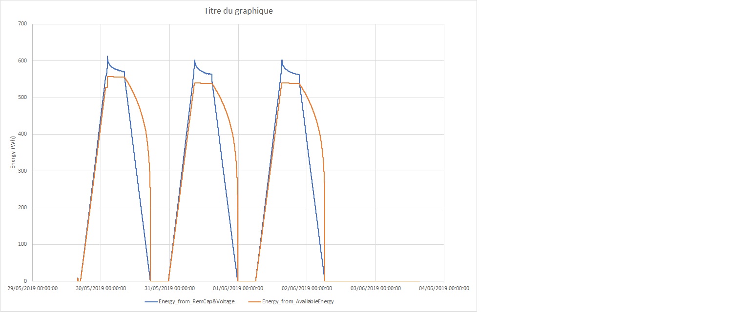

  • Hi Batt,
    looking back at the graph I sent you, it seems there is something wrong even when wrapping is not happening. The Available Energy should be roughly equal to the remaining capacity (RemCap) multiplied by the voltage. Taking every scaling into account the exact calculation is:
    Available Energy (Wh) = (RemCap / 1000) * (Voltage / 1000) * Current_scaling = (AvailableEnergy / 1000) * Current_scaling * Energy_scale * NbSeriesCell
    Which for a 12.8V battery leads to:
    Available Energy (Wh) = (RemCap / 1000) * (Voltage / 1000) * 4 = (AvailableEnergy / 1000) * 4 * 2 * 4
    However when tracing these two graphs for the constant current discharge of a learning cycle, we can see that the curve for available energy is excessively 'ballooning' toward an overestimation of the available energy before quickly decreasing.
    Even without wrapping this curve shape does not match with a constant current discharge. It seems there is something going wrong in the available energy calculation also during discharge.

    This learning cycle did not exhibit the wrapping of the AvailableEnergy counter, though the value went past the point where the wrapping occurred with a 54.4Ah battery. However the overestimation of the AvailableEnergy during discharge is still an issue. You can see in the file below a comparison of the learning cycles of these two batteries (i.e. 12.8V 54.4Ah with wrapping and 12.8V 83.2Ah without wrapping, both show an overestimation of available energy during discharge).
    learning cycle comparison.docx
    I can also provide the srec file of the 12.8V 54.4Ah battery after its learning cycle for comparison, you will find it below. I do not have an srec file before learning for this battery, however it was generated in the same way than for the 83.2Ah battery, only the capacities and design energy scale will be different.
    HET_LiFe_12.8V_54.4Ah_GI-bq34z100G1.zip
    These two issues, namely the wrapping of the AvailableEnergy counter during charge and its overestimation during discharge, must be addressed so we can be confident in the readings that are provided by the gauge to our system.
