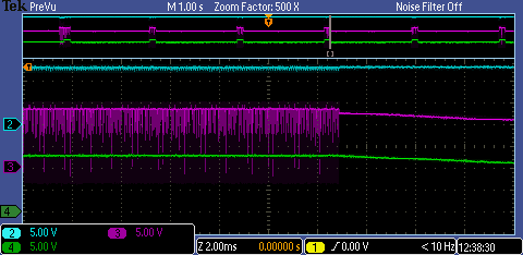

        Before CE is enable, I measured some signals voltage value. VCC: 13.681V, SRN: 10.421V, VFB: 1.69V.
        After CE is enable, the waveforms were recorded as follows.
        Channel 2(blue): VCC
        Channel 3(pink):  PH
        Channel 4(green) : SRN
        All configurations are as described earlier.
        Please help to analyze the problem. What should I do next?

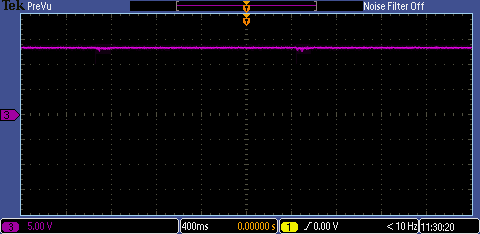

  • Hi, Kedar
    The test waveforms have been uploaded.

       If possible can you try increasing the input voltage as a check? Another step is to monitor ACDRV on a scope at your current VCC to see if there is any oscillation (I am looking to see if ACDRV is ever transitioning between VCC and VCC-6V). It also looks like you are measuring the DC value of SRN before CE but SRN voltage jumps to near your set charge regulation point (5V scale is hard to see accurately, include a cursor measuring how high SRN is going on above graph). This can happen if there is impedance (impedance* charge current adds voltage sensed by IC) between where the charger senses battery voltage and the actual battery. It is possible your battery is already fully charged, and the delay when STAT1 is high, is the battery discharging to recharge threshold which will re-initiate a charge cycle.
       If there is no ACDRV oscillation, and you observe SRN jumping up to your set charge regulation voltage, then this is normal operation of BQ24610 w.r.t to the charger starting a new charge cycle if battery recharge threshold is hit, as this keeps a battery topped up to full charge. Let me know if you have any questions.
