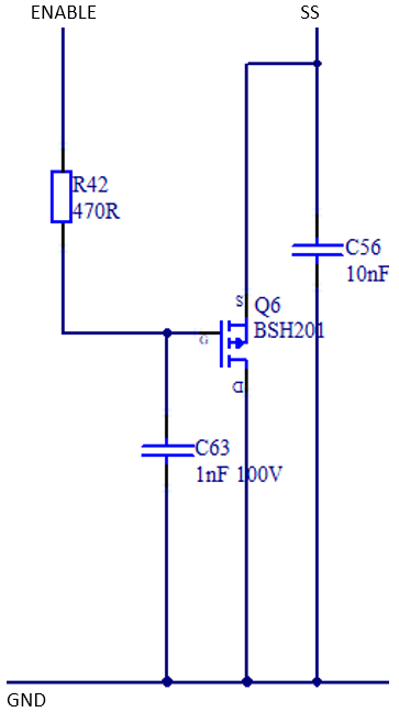

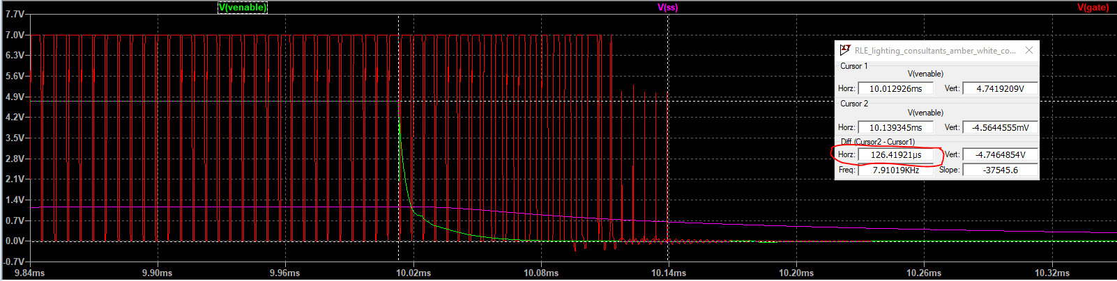

(2) I'm using a p-type MOSFET (BSH201) to enable/disable the converter on the SS pin however, it takes approximately 130us to fully disable the converter which is the time I apply a signal from the microcontroller to the time PWM switching ceases. I require a quicker turn-off (almost instanteous) as I'm turning on a bleed resistor on the output to discharge the output voltage below a certain threshold. How do I make the disabling of the converter more responsive?

2. Remove C63 to help with the switching time of your circuit. Beyond that it’s the RDS on of your FET discharging the SS cap.
