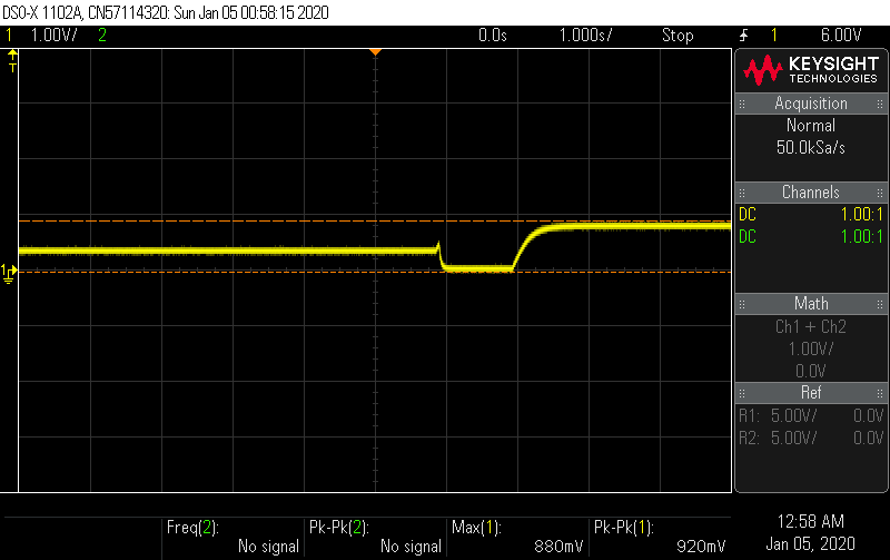

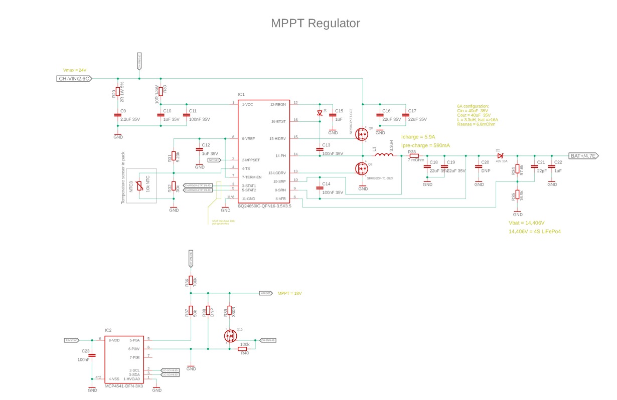

I would like to ask you for help with battery charge controller BQ24650. We have problem with battery charging, when we connect battery to output, then charger output voltage goes down.
.Before we connect battery, we have following behavior:
  • Feedback is 1.6V – 2.08V
  • V ripples are around 1.4V
  • Negative spikes 5.6V
After we connect battery, charger not charging.
  • Battery has 13.6V
  • Feedback 2.00V
  • Voltage before diode: 0.85V
We followed TI reference schema (Preventing BQ24650 Leakage Current When Using Shaded Solar Panels - slva829.pdf, page 9.):
R1 = 16.9kOhm
R2 = 97.6kOhm
C (after diode) = 1uF
Diode PDS1040-13
Please can you help me with this issue?
