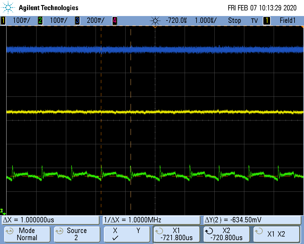

  • Using the EVB as example, can we estimate the range of Ton and Fsw? I found this in one of the DCAP doc and the freq could rely on the output cap ESR and C. Wonder if this is related.
    There are in general 2 problems.
    1. The regulator seems to have low freq ~15kHz before we load it to ~2A. After we have done that, the regulator input/output no longer has this 15kHz frequency.
    2. When the regulator is running at 1MHz freq at the output, we noticed this 1MHz can be seen at the input of the regulator (Vin). Have u seen this before?

    For question 2, Fsw is 1Mhz, It is normal Vin ripple is 1Mhz, not fully understand what are worrying about..

    Q2: What is the ripple you typically seeing at the input VIn? I checked through the doc, it seems no measurement on Vin so far.
  • Generally <hundreds of mv, depends on vin voltage/external power source ability..., if you think it is abormal with your test, please upload your waveforms for review.
    Yuchang
  • Please see below oscilloscope plot
    Yellow - Vout
    Green - Vin
  • From your waveform, the Vin ripple is smaller than 100mv, that's ok.
