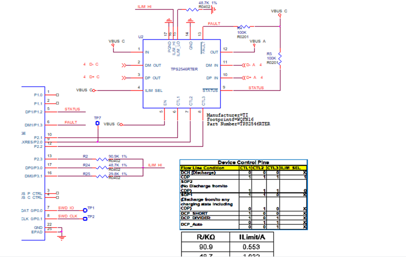

      I have an issue on TPS2546. Customer Bizlink dongle, C to A, C connect to NB, A connect Samsung product.  We find below issue.
  1. When Samsung product is in open status, charging current is 1A.
  2. When Samsung product is in close status, charging current is 0.5A.
Waveform shows different waveform on D+D-, plus CTL pins. Please check the attachment, and help to check if any risk here.
D+ D-.zip
波形.zip

  • Hello April,
    I do see one potential issue. On slide two, for the "power off" capture, why is the voltage on CTL3 not 3.3V like the other CTL pins? This may be read as a value of 0 instead of 1. This would put the TPS2546 in a SDP (CTL1,2 = 1 CTL3 = 0) charging scheme instead of the DCP_Auto (CTL1,2,3 = 1). This would explain why the waveforms look different between the two.
    If you want the same charging scheme for all situations, recommend that you pull the CTL pins to the input supply to the TPS2546
  • Hi   Adam,
    Customer feedback the board they capture waveforms is broken, and the waveform we reviewed is not correct. Today they use a board with no issue and capture the waveform again. Issue is still there, but CTL1, 2 3 performance is not same. Please refer to this attachment.  Please note, when we use a loading tool and test, no issue.
    Samsung product in close status,  Charging current 0.5A.
     Samsung product in open status, charging current 1.5A.
     7457.waveform.pptx
    Customer tried to SET CTL1,2,3 to 101, and in DCP mode, current is ok. But DCP mode could not transfer DATA. Just for your reference. Please help to check.
    Any concern or problem, please let me know. Thanks.

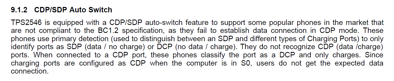

  • Hi April,
    Apologies for the late reply. Thank you for the clarification of the failing board sending the updated captures. I believe this is expected behavior, and what you are seeing is the CDP-SDP auto switch functionality of the TPS2546. This functionality is explained in the datasheet, but I've also included it in the capture below.
    Summary is that when the TPS2546 is configured to be in CDP mode, it will automatically switch to SDP charging if the connected device does not follow he proper enumeration for CDP charging. In this case, when the Samsung phone is closed, it does not follow the CDP charging scheme, so the TPS2546 automatically switches to SDP so that the phone can be charged as well as transfer data. When the TPS2546 changes charging schemes, it must dissipate VBUS, which is why you see a drop on VBUS between the two.
    This is expected behavior and is not an issue. Let me know if you have any other questions
