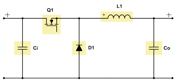

    Just to clarify, if I'm using the output of any of these ICs to drive the high-side FET (which you say is doable), do I just use a diode for the low-side FET? Or would I need additional circuitry that inverts the output of the PWM ICs and drives an actual low-side FET?
    This is why I was hoping there was some Application Note schematic. Some of these details aren't perfectly clear to me.
    Juan
  • Hey Juan,
    You are correct that the bottom "FET" is a diode as shown in the below picture:
    If you were to use a FET instead you would need to have a way to invert the signal coming out of the UC1843B-SP
    Daniel
