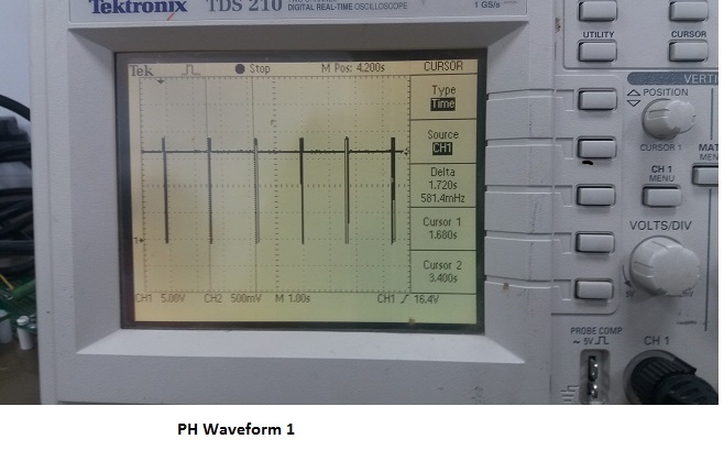

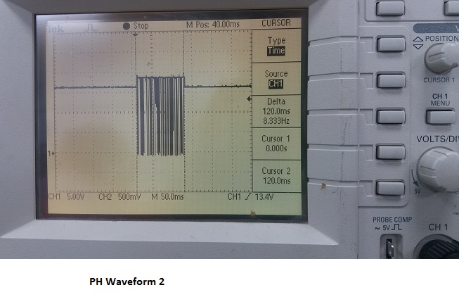

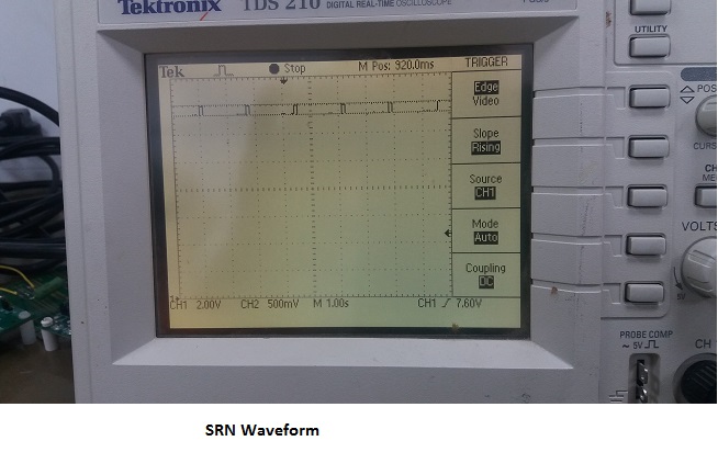

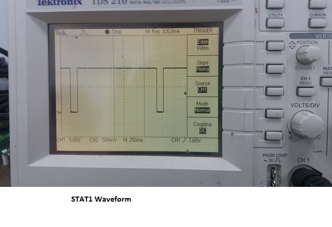

  • Hi Kedar,
    I have taken the scope screenshots.
    They appear in the attached pictures.
    What maybe a reason for this behavior?

  • Hi Michael,
    Can you perform the following tests
    • Change power supply input voltage to 24V and retest
      • Check whether you have any CC limit on the actual power supply itself and remove if so
    • Keep initial 19V supply
      • Do you have long wires in between battery and SRN?
      • Monitor VFB with multimeter throughout harge profile, and log DC value at which you observe the STAT flashing
      • If possible, lower your charge current to 1A and re-test
