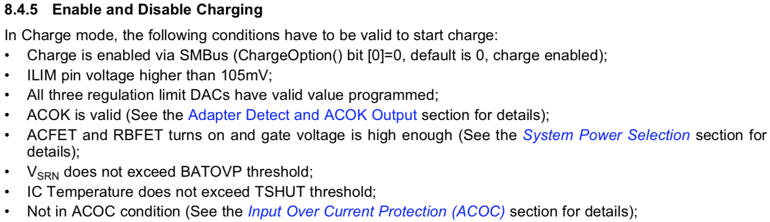

    Through the oscilloscope I see all the ACKs, but the BQ24725A doesn't work, "doesn't charge the battery".
    What could be wrong?
    Can you please check whether the conditions listed below are true? All of these conditions must be met in order to enable charging:
    Also, what is your adapter voltage? Your charge voltage register is set to 16.8 V. Since the BQ24725A is a buck charger, the adapter voltage must be higher than the max charge voltage.
    Angelo

    I noticed that when I give the read command of the values ​​that were written, the values ​​come very different. reading ManufacturerID () gives the data: 0x0000 and DeviceID () brings the data: 0x0000. A basic question, I am using I2C and not SMBus, can this be the problem?
    Yes, it's possible that you are not writing to the registers correctly. Since the ChargeCurrent and ChargeVoltage registers are both zero at POR, there will be no charging until a valid value is written to these registers.
    Can you read back all the register values to see if the values you wrote actually went through?
    Angelo
  • Ok, solved this problem.
    When reading the data already sent, I noticed that they were inverted the high part with the low part.
    write 0xF902
    read 0x02F9.
     so I used the swap and started loading.
