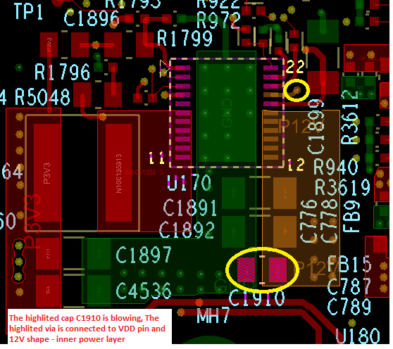

We have designed a server motherboard based on Intel's purely platform. The power controllers were used in the design are of TI and we took the help of webench for the reference design. We have been facing power issues while testing those boards. we are planning for the V2.0 release of the design. Before going for that step, we want our design to be reviewed by TI.
During the bring up some input capacitors were blown. (Refdes: C1874, C1910). - schematic is attached

    Input capacitors are blowing refdes are C1910, C4040, C1874
    The voltage applied to caps is 12V
    CAP, CER, 4.7uF, 25V, 10%, X5R, 0805 : Taiyo Yuden Corporation : TMK212BJ475MG-T
    Can you please share the WeBench output files in PDF format for these designs?
    Also, if you have some graphics that show the placement of the VIN bypass capacitors relative to the TPS53353 converters and they ground connections back to the thermal pad of the TPS53353 controller, that will help us offer suggestions.
    The devices that are identified as blowing up are the 4.7uF VDD to ground bypass capacitors.  As 25V ceramic capacitors, it is unlikely that they are being damaged by over-voltage, but the input RMS ripple of a Synchronous BUCK converter can be very high, and these schematics show only 1 or 2 VIN to GND bypass capacitors carrying 2-3A of RMS current each.  If the primary 22uF or 47uF capacitors are not well bypassed, or are located away from the TPS53353 converter, the 4.7uF VDD bypass capacitor could be trying to carry the majority of this RMS current and failing.
    As a general practice, it would be preferred to separate the VIN and VDD inputs with a 10-ohm resistor for a 12V input in order to keep VIN switching currents out of the VDD bypass capacitor.  It is also preferred for the VIN bypass capacitors to have a tight loop with multiple vias if changing layers, from the VIN IC pins through the device to its thermal pad, back to the ground of the VIN bypass pins and then from the VIN terminal of the capacitors back to the IC VIN pins.

    I have also probed the capacitors with trigger mode during power on - multiple times. The voltage across the capacitors are not going beyond 12.5V with 12V nominal voltage input.

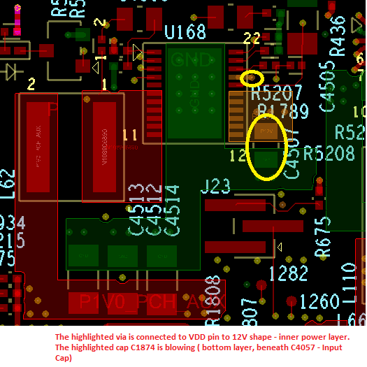

    I am attaching the layout snapshots of three supplies with C1910, C4040, C1874 as VDD capacitors.

  • C1910 - P3V3
    C4040 - P3V3_AUX
    c1874 - P1V0

  • Hi Neha,
        It looks like the VDD capacitors are quite far away from the pin. Have you tried getting an EVM board and changing the BOM components on the board to your BOM components? If so, that could give an indication that the layout is an issue.

  • Hi Gerold
    The maximum air gap between the cap and ic pins is ~350mil.

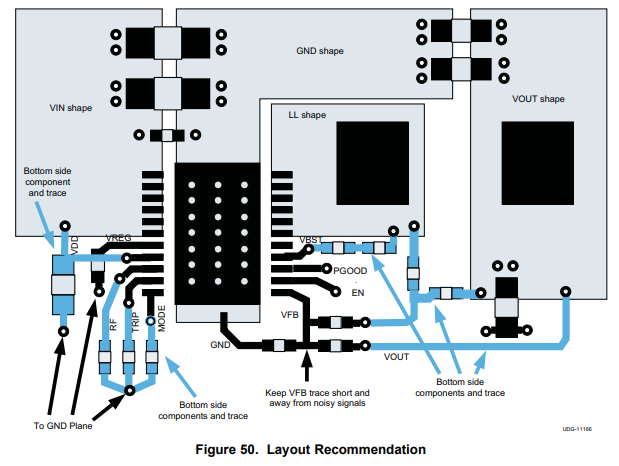

    The reference layout in the datasheet suggests that the VDD bypass cap to be placed on the bottom layer and it has a different trace to connect to 12V. In our case Input caps and VDD bypass caps are sharing the same shape (top) and in some cases, this VDD bypass cap is closer to IC than the Input caps.
    Is there any chance that VDD bypass cap is taking more input ripple and blowing because they are closer?

  • Hi Neha,
         The VDD pin should have a dedicated cap that is closer to the IC. In your case the VDD cap is far away from the IC and essentially the pin does not have any bypass cap now. This might be creating too much ripple and causing the capacitor to blow.
    Can you try putting a higher current rating capacitor for the VDD caps - to see if those can withstand the ripple current?
    What happens to the converter after the caps blow up? Is the converter shutting down?
    Anyway, this might be needing a new layout. Are you considering a board respin at this point?

    The reason the 4.7uF VDD bypass capacitor in your design was failing is most likely due to excessive layout parasitics between this 4.7uF bypass capacitance and the primary VIN to ground bypass capacitance causing the 4.7uF capacitor to handle the majority of the RMS ripple current flowing into the VIN pins.  The input current of a BUCK regulator has very high RMS ripple current.  Normally, this input RMS current is spread between multiple parallel input capacitors to distribute the thermal stress across multiple devices, but this AC ripple current sharing is subject to the effects of the parasitic inductance between the capacitors.
    In your layouts, especially the U168, the 4.7uF capacitor is located closest to the IC while the 22uF bypass capacitors are located further away.  That arrangement will drive most of the high RMS current through the smaller 4.7uF bypass capacitor instead of the 22uF capacitors, which will likely cause them to heat-up and fail.
    Separating the VDD bypass capacitor from VIN with a 10-ohm resistor will certainly help reduce the RMS stress on the VDD bypass capacitor, but making sure the 10uF and 22uF bypass capacitors from VIN to GND are located as close to the TPS53355 as design rules allow, have similar parasitic impedances and sufficient RMS ripple current handling will help equally distribute their current handling.
