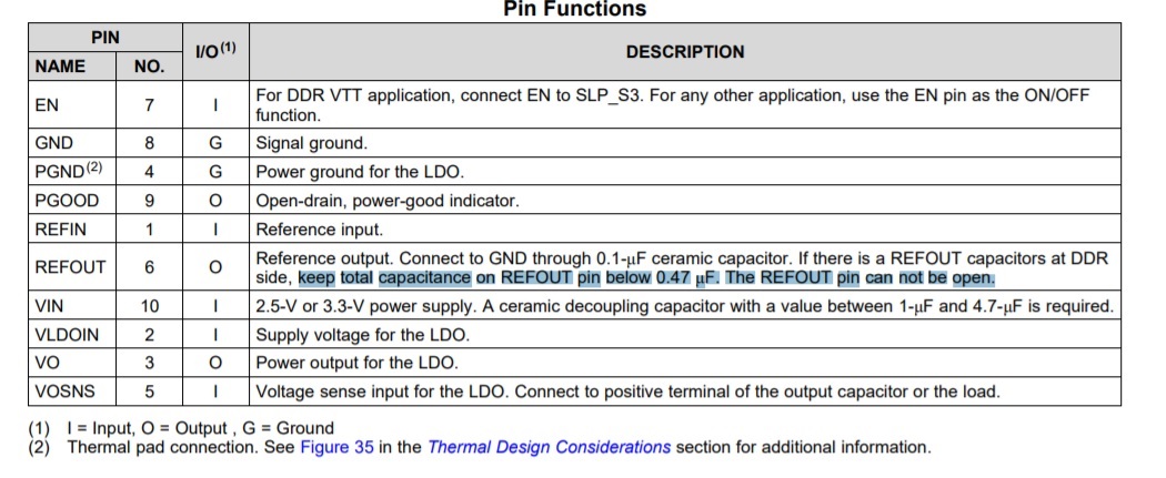

Hello team,
TPS51200 datasheet at page 4 was changed as below picture.
In the datasheet rev.D. "keep total REFOUT capacitance below 0.47 μF" was added.
Q1) Why was it added?
Q2) In my customer condition, total REFOUT capacitance is 10 μF.  What is the concern?
Your advise would be so appreciated.
