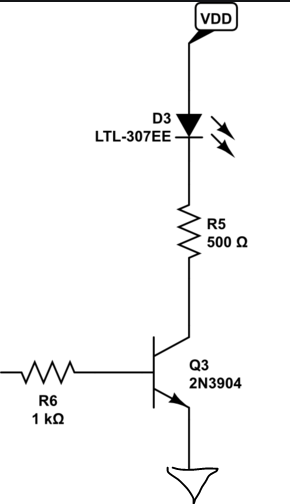

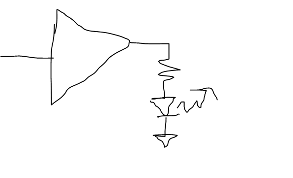

  • Could you share where REDLIGHT / YELLOW light is connected to? Was the LED burned out after the shorting issues?
    Is that connected directly or you have resistor in series with LED? Because a low power LED doesn't need 24V, the only voltage drop i see is the 40v schottky
    Peeyush Tekriwal said:
    Also, is this a good application for this particular IC?
    Not really, for one, this IC can support way higher drive currents than you need. Secondly, there is no currently limiting resistor that i can see.
    To drive a simple LED, you dont need this IC. You can use a general purpose buffer or even BJT circuit which is much easier!
    Best
    Dimitri

  • I am not exactly sure about the exact cause for the failure, especially because the current is very low. for each. Unless you are driving many many LEDS in parallel for 1s on-time ( you mentioned it was a LED string for tree lights) on all LED and you are drawing current on the order of amps, the IC will overheat and damage as it was not designed to this. That is one possible cause.
    It wasn't clear from your earlier message, If your use case is to source current to many LEDs in parallel simultaneously, you should not use the device because the internal mosfet are not designed for sustained currents, this would need to drive a Lowside FET (or highside, with a redesign of supply) that can take the current for such a time.
    If by isolation, you mean about taking care of the level-shifting requirement from your 5V to 24V, know that this is not a requirement for an isolated gate driver because the power planes do not need isolation such as for safety, and the Grounds won't be seperated anyways.
    To take care of levelshifting, the BJT circuit will work a s level shifter from 5v input to 24V with just a 5V. We also have non-isolated gate drivers that would work to drive a highside or lowside MOSFET like a load-switch for a string of many LEDs. Isolated will work, but for this application, its not required. Rough rule is, <600V working voltage you can choose a non-iso gate driver.
