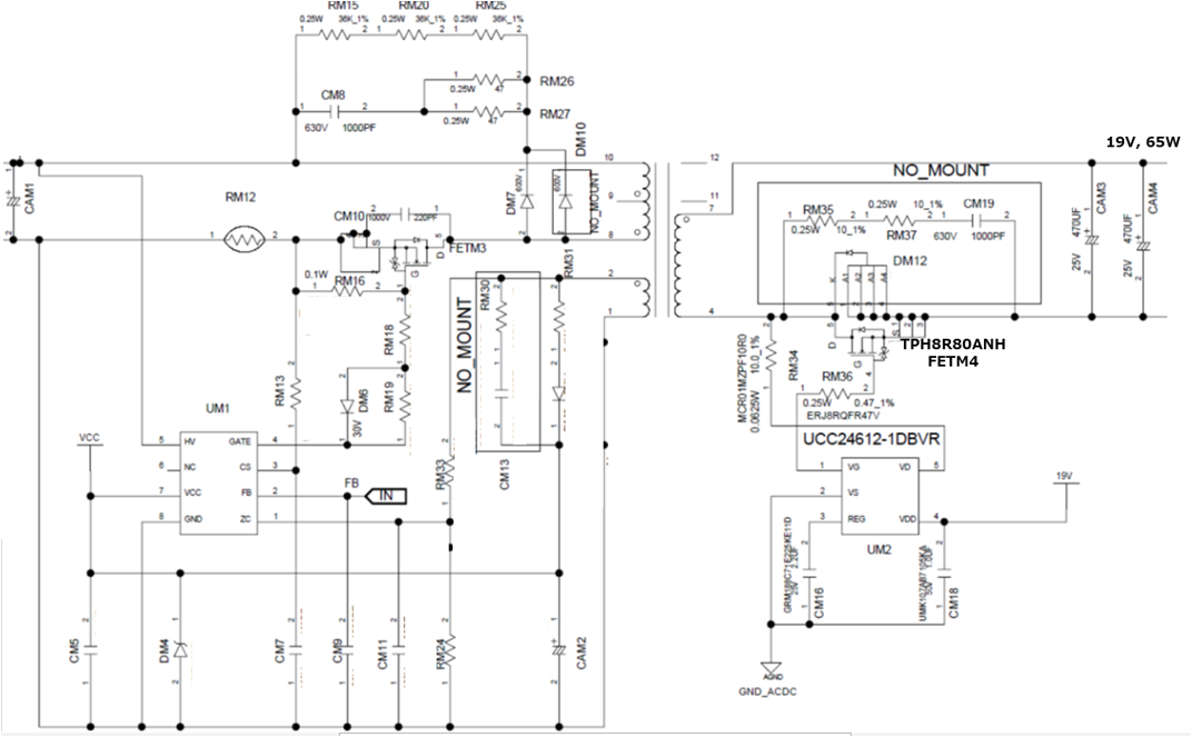

The UCC24612-1 is used in the QR flyback circuit.

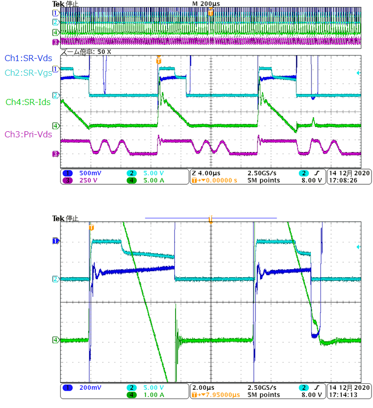

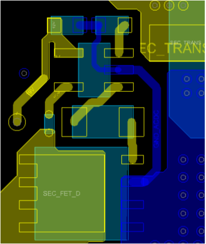

I have a question regarding the delay in turn-off of UCC24612-1.
Is there anything I can try on this issue?
It is irregular and not load dependent.
Some ICs do not occur even in the same reel lot.
Changing to a FET with a large RDS_ON will improve it, but it cannot be suppressed.
The point at which Vgs drops (VTHREG) also appears to change.
