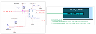

    AM62A7: Changing the VDD_CORE voltage
    If you are using the SK-AM62A-LP EVM with the TPS65931211-Q1 PMIC, then you can modify the hardware to change the default voltage on VDD_CORE which is supplied by the PMIC multi-phase Buck1/2/3.
    The GPIO6 of the PMIC was configured to set the voltage on Buck1/2/3 with the following polarity:
    • High: Buck1/2/3 = 0.85V
    • Low: Buck1/2/3 = 0.75V
    During power up, the PFSM for the '1211 reads the state of GPIO6 10ms after it has enabled the 3.3V load switch. If GPIO6 is pulled up to that signal, BUCK123 will be 0.85V.
    Therefore, from the PMIC perspective Pull GPIO6 HIGH to the 3.3V load switch signal

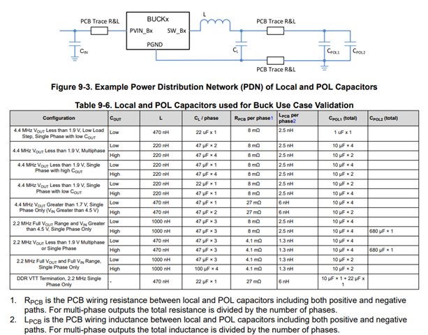

    Inputs on power supply sizing:
    Using Maximum Current Ratings application note vs Power Estimation Tool PET
    The max current app note is representing the current draw for a group of rails. Please note that it is not expected for this current to necessarily be replicated in the power estimation tool. The PET will tend to show more average use case power while the max current app note is intended to be used for power supply sizing as it will allow for the max transient on these groups with some margin. The PET should not be used for power supply sizing.
    Power Estimation Tool (PET) and the max current rating apps note serve two different purposes. The PET is used to estimate active power consumption for a specific use case/application. The max current rating apps note can be used for supply sizing when designing a custom power solution
    Sreenivasa
  • HI Board designers,
    Note:
    How were these pdn specs derived? Is it based on worst case analysis?
    Yes it is based on worst case load transient estimates for a given SoC design.
    The Target impedance for AM62x and AM62xSiP will be identical as the same worst case load transients exist on both designs since they share the same die.
    Via sharing recommendations in the escape application note are only made to help guide a customer to escape the design with fewer vias in the VCA regions. The number of vias used for escaping signals will ultimately depend on the specific customer use-case, the number of interfaces that need to be implemented and the layer count. If the specific use case allows the customer to use more vias for VDD_CORE in the VCA regions, that is definitely a valid approach. Per-pin loop inductance guidelines are more applicable for single-pin supplies that are connected to a decap. In case of multi-pin supplies like VDD_CORE where there are a number of parallel connections to multiple pins/decap thru multiple vias, it is hard to tie it back in to a per-pin requirement. The most important target to meet is the impedance target specified in Table 7-6 of the PDN Applications note. This table is the same for AM62x and AM62x SiP.
    We do not include Buck output inductance in PDN simulations.
    For VDDS_DDR: we do not recommend using target impedance as the signoff for DDR.
    Refer to the AM62x, AM62Lx DDR Board Design and Layout Guidelines which outlines all details of power aware SI/PI simulations
    that need to be run. The eye mask checks from these power aware simulations are the signoff.
    Power Distribution Networks: Implementation and Analysis
    Sitara Processor Power Distribution Networks: Implementation and Analysis
    https://www.ti.com/lit/pdf/sprac76
    Note: The decoupling capacitor numbers and type on the SK/EVM are only intended to serve as a guideline for customers. The true pass/fail criteria is the target impedance published in the PDN app note.

    Inputs on PDN
    (+) [FAQ] AM62A3-Q1: AM62A3-Q1 PDN Power SI SIMULATION Questions - Processors forum - Processors - TI E2E support forums
    Please refer below inputs i received:
    Please note these are only recommendations and they need to contact their EDA vendor on what works best for their specific simulation environment.
    1、Do I need to separate VDD_CORE-1 to 17 for simulation, or use VDD_CORE as a Port?
    TI>> You can lump all VDD_CORE BGAs together as a single terminal for the port
    2、Do I need to include the PMIC FB loop in the simulation?
    TI>> If you are simulating only for AC impedance (target impedance checks) this is not required. The board layout from the inductor onwards (inductor not included) can be modeled and PMIC FB loop can be studied separately.
    3、 Is the simulation starting frequency from 1Hz or from a minimum of 100kHz for the capacitor S2P?
    TI>> There should be some DC frequency points added. Please check with your EDA vendor on the exact setup and simulation points needed to generate causal models.
    I added additional inputs related to PDN and decoupling capacitors for reference.
    The voltage at the device ball must never be below the MIN voltage or above the MAX voltage for any amount of time. This requirement includes dynamic voltage events such as AC ripple, voltage transients, voltage dips, and so forth
    PCB design & Dcap scheme combine to form your board's Power Distribution Network (PDN) that should meet recommended SoC PI performance targets for robust processor operations. Each PCB design has a "unique finger-print" based upon component placements, power & Gnd routing, layer assignments, via qtys & locations, Dcap mounting & loop inductance, Dcap parameters, etc. As a result, an optimized Dcap scheme will vary from one PCB design to another but should provide a system PDN that meets PI performance targets when combined together. Similarly, the PI simulation tools can impact the estimated ZvsF response values, especially above 3.0MHz where non-3D extraction tools can return better Z values (10-15% less than more accurate 3D tools). This ican be due to a non-3D tool is only extracting a PCB's X & Y design elements & assuming a power & Gnd via inductances.  Due to the 3D nature of current flow across & through a PCB from power & Gnd planes on different PCB layers, a 3D extraction gives a more accurate series inductance estimate needed to more accurately model power & Gnd vias which leads to a more accurate power rail impedance (ZvsF) response
    it would be difficult to comment on reducing the amount of decoupling caps without going through the exercise ourselves.  That said, you can likely prioritize the high-current and sensitive analog rails, then look to share bypass caps when you hit space constraints.  Having decap as close to the BGA as possible will reduce inductance and improve their efficacy (two supply vias with a shared decap would be better than a decap located far away in most circumstances).
    Please be aware that each PCB design is unique and may need different Dcap scheme to meet recommended PI parameter targets
    Regarding decoupling capacitors, the recommendation is to start with the EVMs decoupling and then optimize (if needed) based on your power simulation results.
    For the placement of the Caps and values, we would still recommend using the EVM as a reference along with the PDN document.
    SK uses an EMI Filter at 1uF, can I replace it with a general ceramic capacitor?
    The SK performance has been tested with 3-T terminal caps.
    You may have to add multiple 2-T caps for each cap and perform simulations to finalize the values.

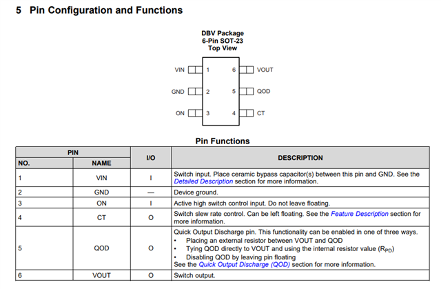

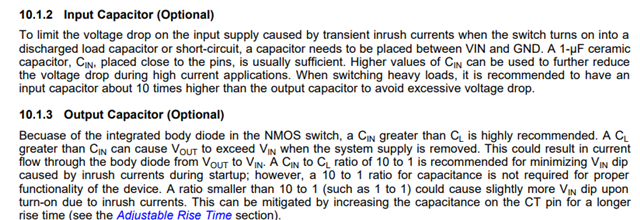

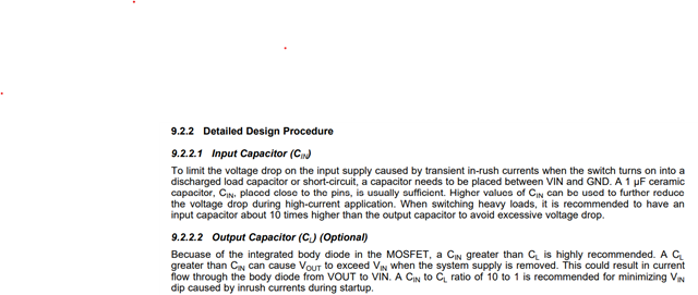

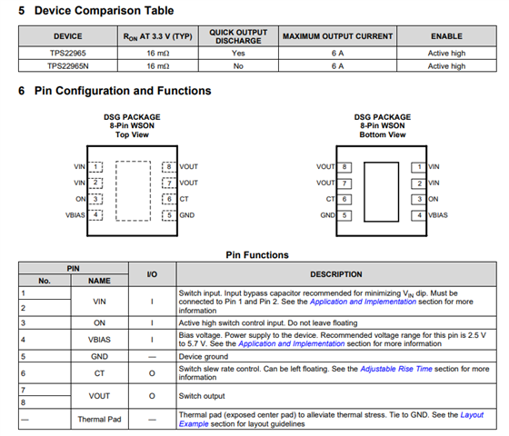

  • Hi Board designers,
    Refer below input related to eFuse caps and pinout
    TPS22918 5.5-V, 2-A, 52-mΩ On-Resistance Load Switch

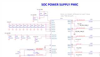

    FYI only (can be used as reference)
    (+) TDA4VM: PMIC reports VDD_CPU overcurrent error - Processors forum - Processors - TI E2E support forums
    A few important points...
    1. BUCKn_ILIM_INT is related to instantaneous forward current and it has an accuracy spec described by ILIM_FWD_PEAK_Accuracy in the data sheet. It is -15% to +10% for this use case. Because of this range, it could be possible for the ILIM interrupt to trigger during a fast heavy load transient event.
    2. The limit is a hard limit, no additional current is allowed through the top side FET once it is hit.
    3. For the TPS65941213 and LP876411B4, the BUCKn_ILIM_INT is informational only. It will not cause the PMIC to shut down or cause a recovery attempt on its own.
    The fact you are seeing these particular interrupts, you should double check your schematic and layout out for two things:
    1. Make sure that BUCK1_FB and BUCK2_FB are routed as a differential pair out to the POL caps.
    2. Make sure there is enough output capacitance after accounting for tolerances and derating. There should be a minimum of 100uF per phase.
    Early versions of TDA4 SKs and EVMs had small mistakes on the above two points. Boards powered up and were functional but some saw subpar stability on stability on buck performance.

    This excerpt from the Buck Output Capacitors subsection of the Application and Implementation chapter in the TPS6594-Q1 datasheet shows that the 3-terminal capacitors are recommended.
    There are also 3-terminal in the input of the buck, why we also need add them in the input? Thanks!
    Thanks for the clarification. I now see the capacitors in your question are each connected to one of the BUCK inputs 1-4. The 3-terminal capacitors were used here due to the PVIN also being a noisy signal that benefits from a low inductance capacitor. Looking at the Layout Guidelines in the TPS6594-Q1 datasheet, we can find that the most important parameter of the decoupling capacitors on PVIN_Bn is the inductance.
    These capacitors are helpful to minimize the effect of the BUCKs switching at 2.2 MHz or 4.4 MHz on the VCCA rail. These provide capacitance at a lower inductance that is more capable of managing the high frequency current switching. PVIN_B5 does not have one of these 3-terminal capacitors due to the relatively low current draw of BUCK5.

    Is there any suggestions from ur side? The SCH is shown below.
    PS, attached the PMIC SCH design in our project as below, which also be reviewed by TI.
    I remember this one, my apologies, the understanding was that the input supply from VCCA, PVIN_Bx, & PVIN_LDOx would all be switched over to 5V, not just a select few.
    If they have a choice between using 5V input on the previously mentioned pins of VCCA, PVIN_Bx, & PVIN_LDOx or 3V3, using 3V3 they need to pick one and use all three of these inputs, please have them review section 3.1.2 in the User's guide

  • Hi Board Designers,
    Inputs related to load switch slew rate control, QOD and output cap.
    https://www.ti.com/lit/ds/symlink/tps22918.pdf
    9.2.2.1 Input Capacitor (CIN)
    To limit the voltage drop on the input supply caused by transient in-rush currents when the switch turns on into a
    discharged load capacitor or short-circuit, a capacitor needs to be placed between VIN and GND. A 1 µF ceramic
    capacitor, CIN, placed close to the pins, is usually sufficient. Higher values of CIN can be used to further reduce
    the voltage drop during high-current application. When switching heavy loads, it is recommended to have an
    input capacitor about 10 times higher than the output capacitor to avoid excessive voltage drop.
    9.2.2.2 Output Capacitor (CL) (Optional)
    Becuase of the integrated body diode in the MOSFET, a CIN greater than CL
    is highly recommended. A CL
    greater than CIN can cause VOUT to exceed VIN when the system supply is removed. This could result in current
    flow through the body diode from VOUT to VIN. A CIN to CL
    ratio of 10 to 1 is recommended for minimizing VIN
    dip caused by inrush currents during startup.
    Inputs related to load switch implementation
    https://www.ti.com/lit/ds/symlink/tps22965.pdf
    10.1.2 Input Capacitor (Optional)
    To limit the voltage drop on the input supply caused by transient inrush currents when the switch turns on into a
    discharged load capacitor or short-circuit, a capacitor needs to be placed between VIN and GND. A 1-µF ceramic
    the voltage drop during high current applications. When switching heavy loads, it is recommended to have an
    10.1.3 Output Capacitor (Optional)
    Becuase of the integrated body diode in the NMOS switch, a CIN greater than CL is highly recommended. A CL
    flow through the body diode from VOUT to VIN. A CIN to CL ratio of 10 to 1 is recommended for minimizing VIN dip
    caused by inrush currents during startup; however, a 10 to 1 ratio for capacitance is not required for proper
    functionality of the device. A ratio smaller than 10 to 1 (such as 1 to 1) could cause slightly more VIN dip upon
    turn-on due to inrush currents. This can be mitigated by increasing the capacitance on the CT pin for a longer
    rise time (see the Adjustable Rise Time section).

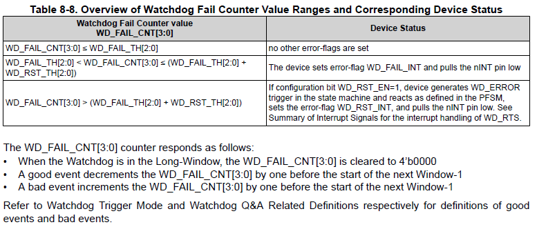

    FYI, inputs related to watchdog
    When the watchdog were triggered, is there a short delay that allows the controller to log some fault status? Or TPS6594-Q1 it will immediately shut down all the rails?
    Are you looking for a method for the Processor to know what caused the watchdog timeout, or can you explain more the use-case so we can best answer the question based on what customer is looking for? Additionally, does the customer already have a particular OPN of the TPS6594 in mind (if so which one, we can check the more specific NVM setting then) or are they looking to do their own custom NVM?
    From the datasheet section 8.3.11.1 Watchdog Fail Counter and Status: www.ti.com/lit/gpn/tps6594-q1
    You can see from this why I ask about the NVM configuration they use, as there are a lot of options so it depends on how you have the part set up. But I wanted to highlight that depending on the use-case, you could set up the WD interrupt threshold so the processor gets a warning on the nINT pin, before enough WD fail events have happened for the WD_RST_TH to hit. Additionally, WD_RST_TH being passed can also generate the WD_ERROR trigger into the state machine and the PFSM can define how the PMIC reacts.
    Can you share which OPN they have chosen or whether they are doing new development?
    Inputs related to capacitor selection.
    www.ti.com/.../tps6593-q1.pdf
    7.5 General Purpose Low Drop-Out Regulators (LDO1, LDO2, LDO3
    (1) Input capacitors must be placed as close as possible to the device pins.
    (2) When DC voltage is applied to a ceramic capacitor, the effective capacitance is reduced due to DC bias effect. The table above therefore lists the minimum value as CAPACITANCE. In order to meet the minimum capacitance requirement, the nominal value of the capacitor may have to be scaled accordingly to take the drop of capacitance into account for a given dc voltage at the outputs of regulators.
    (3) Ceramic capacitors recommended
    (4) Load transient voltage must be considered when selecting UV/OV threshold levels for the LDO output
    (5) Additional capacitance, including local and POL, beyond the specified value can cause the LDO to become unstable
    (4) Additional capacitance, including local and POL, beyond the specified value can cause the LDO to become unstable
    7.8 BUCK1, BUCK2, BUCK3, BUCK4 and BUCK5 Regulators
     TPS6593-Q1: Output Capacitor Selection
    The configuration of each of the rails in the NVM is 2.2 MHz VOUT Less than 1.9 V Multiphase or Single Phase. From the BUCK1, BUCK2, BUCK3, BUCK4, and BUCK5 Regulators section of the Specifications chapter in the TPS6593-Q1 datasheet, this corresponds to a typical effective local capacitance per phase of 22 μF and minimum effective total capacitance of 100 μF. As long as these values listed in the datasheet are met after capacitor derating, the device will function properly.
    Additional considerations are listed in the Buck Output Capacitors section of the Application and Implementation chapter of the datasheet. At the end of the guidelines, it suggests to simulate and validate the capacitor network chosen for a particular design meets the desired requirements. The three 47 μF capacitors were used in our validation, but the customer is able to use any capacitors that meet the guidelines we have written.
    Sreenivasa

    AM62A7 is used for our Car Products TPS6593 is used to power AM62A7 in demo designEVM_sprr459PROC135E2_SCH
    TMUX154 is used in TPS6593 reference desigh page. I guess the mux is used for the case IO+DDR lower power mode or partial IO low power mode , the picture is shown as below.
    IO+DDR low power mode has all the power rails disabled except BUCK4 and BUCK5, which supply the 1.8V IO domain and DDR rails. Partial IO low power mode has all the power rails of the PMIC disabled.
    From the AM62Ax Sitara Processors Technical Reference Manual (Rev. A), In Partial I/O, I/O pins and small logics in the CANUART I/O Bank are active, and the rest of the SoC is turned off. The user can use the I/O pins to aggregate multiple I/O wakeup events and toggle PMIC_LPM_EN pin to enable PMIC or discrete power solution when an I/O wakeup event is triggered. The information on the I/O wakeup event is logged in the MMR in the CANUART I/O bank and helps the software to distinguish between cold boot and wakeup to respond to the wakeup event faster.
    SK-AM62A-LP: SK-AM62A-LP: can't not wakeup the board from I/O Only Plus DDR mode.
    The issue is resolved with using latest release
    https://e2e.ti.com/support/processors-group/processors/f/processors-forum/1209966/sk-am62a-lp-how-the-pmic_lpm_en0-works
    As noted in the AM62A datasheet the PMIC_LPM_EN0 signal is a dual-function PMIC control output. It triggers the low power mode (active low) or enables the PMIC (active high). The connection of this signal to the PMIC will depend on the processor low power mode that is used on the application.
    • PMIC_LPM_EN0 drives the TPS65931211-Q1 enable pin when using Partial IO low power mode.
    • PMIC_LPM_EN0 drives the TPS65931211-Q1 GPIO3 (nSLEEP2) when using IO+DDR low power mode.
    From AM62A data sheet:
    "Partial IO" is a low power mode on the AM62A processor and it is independent from the LP_STANDBY_SEL bit on the PMIC. PMIC_LPM_EN0 is high by default (using the external pull-up resistor). See the AM62A technical reference manual (AM62Ax Sitara Processors Technical Reference Manual (Rev. A)) for more information about each of the low power modes supported on the AM62A processor.
    • PMIC_LPM_EN0 drives the TPS65931211-Q1 enable pin when using AM62A Partial IO low power mode.
      • when EN pin is high, PMIC is in active state (rails ON)
      • when EN pin is low, PMIC executes an orderly power-down and transitions to Standby State (rails OFF)
    • PMIC_LPM_EN0 drives the TPS65931211-Q1 GPIO3 (nSLEEP2) when using AM62A IO+DDR low power mode.
      • when PMIC GPO3 is high, PMIC is in active state (rails ON)
      • when PMIC GPO3 is low, PMIC turns-OFF all rails except Buck4 (VDDS_DDR) and Buck5 (DVDD1V8). The PMIC GPIO4 also stays high to keep the external 3.3V load switch enabled.
     for Partial IO, all the PMIC rails are turned-OFF. Only the external discrete supplying VDDSHV_CANUART and VDD_CANUART are kept ON.
    https://e2e.ti.com/support/processors-group/processors/f/processors-forum/1566755/sk-am62a-lp-am62a7-ic-is-hot-after-poweroff-command/6115095
    If you are using the SK-AM62A-LP EVM, Partial-IO low power mode would be the lowest power/thermal state without disconnecting the pre-regulator and power source. The CANUART voltage domain (VDD_CANUART and VDDSHV_CANUART) are supplied by discrete regulators, external to the PMIC. Even if the PMIC is turned-OFF, CANUART stays enabled.
    For applications that do not require Partial-IO low power mode, the CANUART rails can be supplied with the same regulators that supply VDD_CORE and 3.3V IOs. In this scenario, it would be possible to completely turn-OFF the SOC.
    Partial-IO low power mode has been tested in the SK-AM62A-LP EVM and it worked after adding the overlay. Partial I/O mode can only be tested when k3-am62x-sk-lpm-wkup-sources.dtso overlay is loaded. Please refer to How to enable DT overlays for more details.
    If the overlay is not added, the PMIC_LPM_EN0 signal does not go low.
